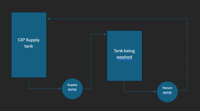

Your drain pump has higher capacity than the supply to your spray ball, so it keeps losing its prime. Without prime it basically stops pumping liquid and acts as a low capacity air suction. It sucks air by churning it into the water in the impeller casing and then separating the air from the water in the chamber above the pump. When the suction pipe becomes filed with liquid, the pump becomes primed and it quickly pumps the suction pipe dry again. A slug of liquid leaves the pump, pushing air in front of it and causing water hammer in the pipe. There will be large forces on the pipe at elbows and the pipe will rattle.
You can prevent this by filling the tank to a low level and then recirculating the drain flow directly back to the spray ball. This way the spray flow will always be equal to the drain flow, and the pump will not lose prime while cleaning the tank.

Apologies, should have started with a sketch, I provide it now:
The tank being washed needs to be empty, otherwise there will be no impact from the sprayball where I have liquid coverage.
So avoiding air entertained in the water cannot happen, I also cannot return the water back to the being washed, or fill it.
