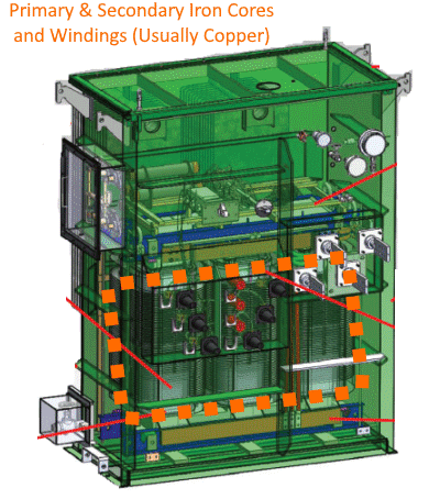

1) Cg = 1/3*H unit, is more likely. Most of a transformer's weight, say 70 to 80%, are the iron core and the wire (usually copper) windings on the core for primary and secondary circuits. In a pad mounted transformer the core / windings are "low", so that hot oil will flow upward by natural convection where it is cooled then recirculates back down to the core. Core & windings surrounded by dotted orange line in this image (ignore the red lines)

Very good, three-phase, 500 KVA pad transformer, that weighs about 5000 lb, and can use a 72" x 94" precast concrete pad with a 50" x 18" opening:
This Eaton 500 KVA transformer comes close to meeting those specs, at least to give you a reasonable basis for preliminary calcs... until the EE delivers the appropriate info.
