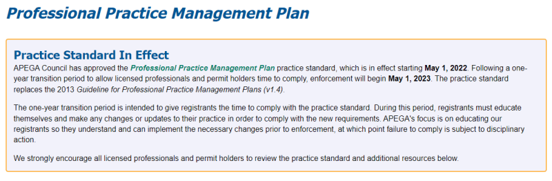

I think the main bottleneck will be getting the P2P because you need to have your practice plan in place and (maybe) some of the continuing education training is mandatory like BC. As noted above, phone into APEGA and also confirm with emails...I have had experiences where they had "oopsies" that were caught only because of the written confirmation.
Maybe not. The practice plan isn't mandatory until 2023. The only hiccup is if the transition period only applies to existing registrants rather than the newly minted.
I suspect you're transferring some of BC's hard-ass ways to AB. We're catching up in that regard but are, currently, still a bit cowboy-ish.
Transition periods are kind of whack. OP is likely planning to do work in the future that requires field review, etc. which should follow (and eventually will have to follow) current guidelines. OP is also asking questions that are explicitly handled in the guidelines (ie. how to digitally authenticate work).
