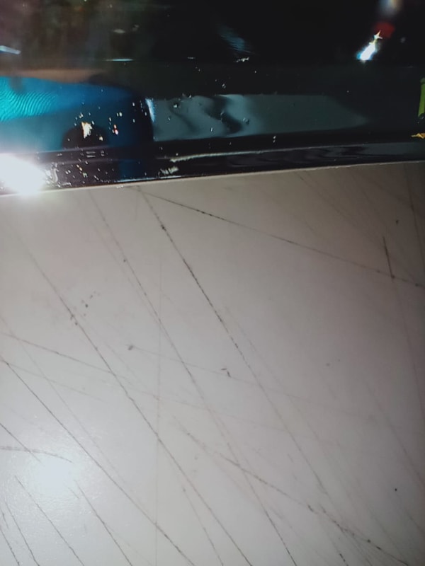

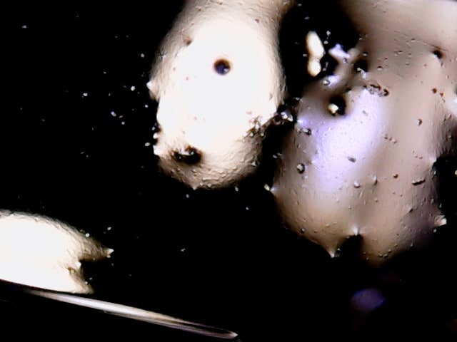

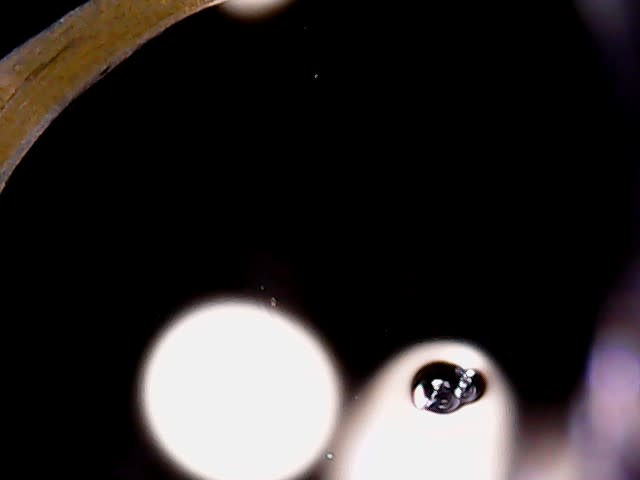

Hy there, i have a few question about painting defect,
now i run my shop for painting plastic material to supply metallizing process, but when we use basecoat material,most of them is not good, like there is bubble, or grain of sand, or even like a contamination.
if you have any clue of it, please give your opinion, thanks

that is the image of defect but after metalizing process
