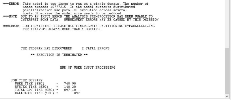

1_Is there any Domain decomposition in ABAQUS/Standard (For example: Static General) ?
1-1_IF The answer is YES, Why i get this error with regard of activation of Parallel execution (14 Processors) "This model is too large to run on a single domain. The number of nodes exceeds 16777215. If the model supports distributed Parallelization, Use Parallel ...."

Domain decomposition is available only in Abaqus/Explicit. Check the documentation chapter "Parallel execution in Abaqus/Standard" for details.
FEA way Thanks For your response.
Also I have another Question:
If There is no Domain decomposition, Then how Software use Parallelization in Job module (I read "Parallel execution in Abaqus/Standard" But I can't find anything useful to my question) ?
BTW, This is the error full massage:
