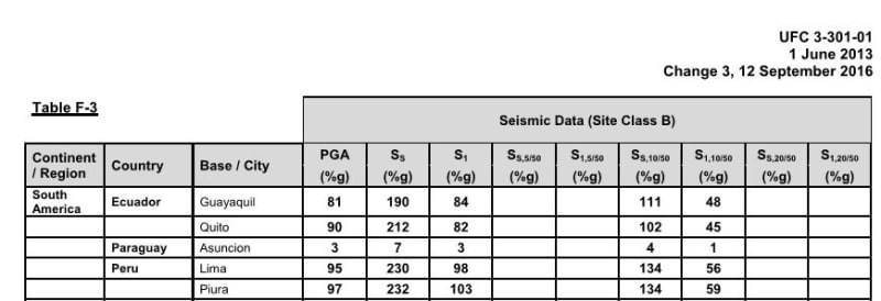

As Retired13 points out, for Peru, you will need to meet the requirements of the local seismic code.
If you want to use ASCE 7 to supplement those requirements and improve your design, here is the data from UFC 3-301-01 that JJL mentioned.
Lima isn't very close to Cuzco, so you'll want to consider that carefully, especially in a country as seismically active as Peru.
