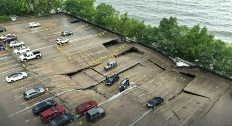

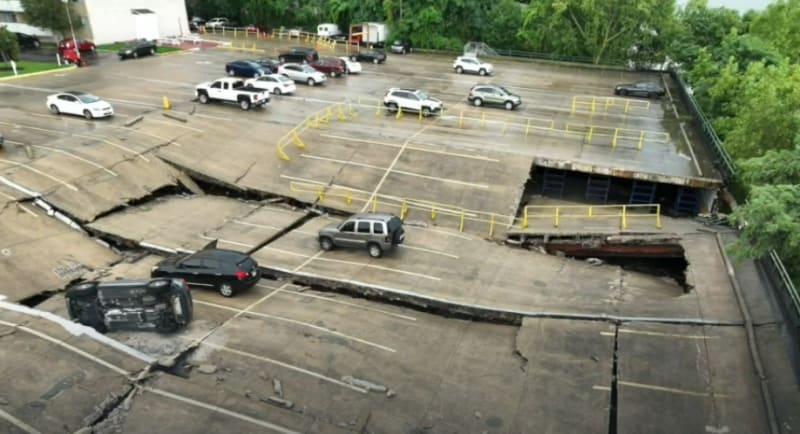

Corrosion and subsequent failure of unbounded PT tendons due to the use of salt to deice used to be a big problem in northern parking garages, but that was a long time ago.
They did get something like 5" of rain that night. Maybe a flat spot on the top deck?
Maybe a plugged drain if water collection was enough.
Hmmmm...are those temporary guardrails/barricades? Could there have been work going on up there prior to the collapse?
There were already barricades around a portion of the parkade when it collapsed
(Google Maps for reference, also here)
cleveland.com
yeah - and shoring on the level below. So they knew there was a problem, but perhaps underestimated the scope or severity. Sounds a little too familiar...

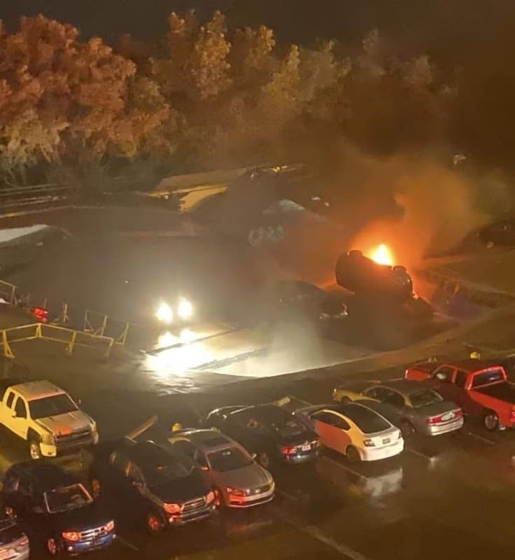

Suggestions of lightning strike causing damage and car fire as well as a resident claiming that I-beams were being replaced to address rust.
