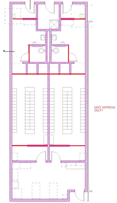

I'm doing ten foot tall interior partition walls in a 26 foot tall space so top of wall bracing is not suitable.
I plan on spanning my walls horizontally between perpendicular walls using the empirical tables. The walls form restrooms and locker rooms and have interior perpendicular walls about every 10 to 16 ft on center (not all perp walls are shown in the image below).
For this type of structure, do most engineers put dowels in their control joints to provide that continuity in long stretches of wall or is there another method?

Maybe something like... with channel sections on the flat?

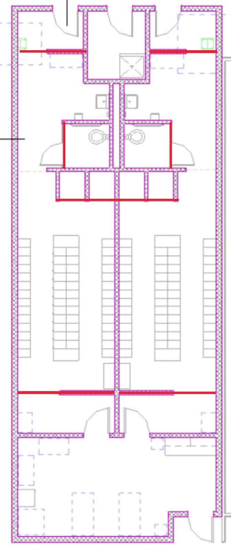

really im more worried about the long perimeter walls and how they interact with control joints. i'll probably put in some sort of return wall at the limiting span. Maybe the joints go at the return walls?
What is supporting the perimeter walls? or are they sticking up 10', too? If so, you may have a dangerous situation on your hands.
thanks, these are 'cantilevering up', yes. but i plan on adding in return walls to comply with the empirical table for limiting horizontal span. The return walls have already been accepted by the architect.
Where the return walls that are already shown dont extend to the perimeter, i will add a transom over the opening and add a pilaster on the perimeter wall.

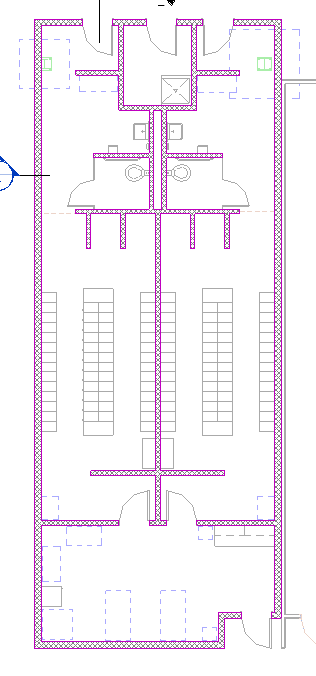

Put reinforced bond beams at the third points in the wall height and tie all the walls together at all the corners. Grout and reinforce a few vert. cells too. This makes for a much stiffer/stronger wall whichever way it spans.
Those sidewalls are awfully long to be free standing... IMHO. [pipe]
@dik, they are very long but in my original post i indicated i would add crosswalls.
Im primarily interested in if how people are treating the joints, not so much as to how to lay it out.
It is typical to continue the horizontal reinforcement in bond beams through the masonry control joints.
