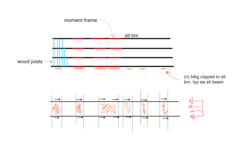

Attached is a schematic view of the diaphragm problem.
The steel beam collectors are continuous.
The plan is to add new blocking w/ clips over all the moment frames, then spaced out.
I sketched a sample diaphragm region on the bottom of the page.
I'm tempted to take make diaphragm regions (shown orange shaded) that carry their own inertial load + the tributary amount from each side where there are no blocking reactions.
Seems to me if I can get blocking at each end of the building, then spaced intermittently in towards the moment frames then I can avoid any tension.
Would love to hear more thoughts hope this sketch helps understanding of the situation.
Not quite what I was envisioning, but now that I see what you’re doing I think you’ve got the concept. A bit of semantics: this doesn’t appear to be a partial-length collector issue, but rather a shear transfer issue. Your solution still relies on the steel beams to act as full length collectors.
If you were trying to reduce the forces on the collectors and their connections (or eliminate them completely) by concentrating your shear transfer at the frames, that would necessitate partial-length collectors. Based on your comments above, that doesn’t appear to be the issue you’re trying to tackle.
Out of curiosity, does your solution offer any advantage over blocking every 3rd or 4th (or whatever) joist bay along the entire length of the beam?

What I am trying to do is to reduce the shear transfer elements outside the moment frame as much as possible.
If I could just have shear transfer over the moment frames that would be the ideal situation. I'm just having trouble visualizing the loading on the diaphragm regions that are not bounded by shear transfer elements. (the unshaded regions in the bottom part of my sketch).
Like I said earlier my feeling is that if I at least have some shear transfer 'in front' of the diaphragm region then it always has something to push against and doesn't have to drag tension through the diaphragm. But after reading Malone and some of the comments here I am worried this might be an over simplification.
In order to have shear transfer over the moment frames only, you'd have to justify a way for all of the diaphragm load to get into your main transfer diaphragm. Perhaps you could rationalize a way that the diaphragm on one side of the frames could strut directly into your main transfer diaphragm, but the diaphragm on the opposite side of the frames (the portion trying to move away from the frames) still has strut into the mini transfer diaphragms and make it's way to the steel beams where it's load is delivered back to the frames via a collector load path. So you're not saving anything over a traditional full-length collector design.
I don't have an issue with what you've shown, but considering what I've written above, uniformly distributed shear transfer elements over the entire length of the collector may net you the same design, and they would be simpler to detail and convey on the drawings.

If you wanted to localize the attachment as much as possible and you could make the numbers work, you could provide the full depth blocking only locally at the the far ends of the collectors and omit it entirely above the moment frames. As a general principle, one likes to place resistance as near to load source as possible but that is by no means mandatory if you've got good reasons to do otherwise.
@koot this is what I ended up with I have a new blocking region at each end that makes up new transfer diaphragms. And another transfer region over the moment frames.
I determined the length of the two outside transfer diaphragms based on the assumed diaphragm strength and assuming that the unblocked regions only react on the transfer regions in 'compression'. Checked my arrangement for EQ loads in either direction, then design the collector and it's splices with only loading coming from the transfer diaphragm regions.
Numbers worked out pretty well and we're happy with the arrangement. I told my boss I did about as much Terry Malone as I could muster lol.
