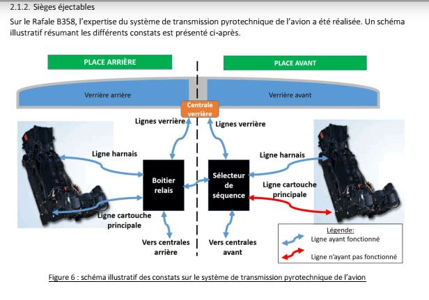

OK, maybe not a failure per se, though in fact the fact that the pilot did not eject, as the system is supposed to, is a failure as is the apparent very lackadaisical attitude to safety, briefing and installation into the aircraft.
But at least the guy survived in one place without a heart attack, which at a reported heart rate of 140 BEFORE the incident is quite a miracle.
There are a number of reports on this but the one below is a bit more "technical". Apparently the heart rate was recorded on his watch and wasn't known to the flight crew before hand. I can't find a link to the actual report itself so if anyone can find it please add it in, although it will be in French of course....

3D - If you read the reports and the one linked within it it is noted that the rear seat ejection on its own ruptured some device which should have also ejected the pilot and when he landed he got out of the aircraft very quickly as he knew the seat was "live". It lost both canopies apparently, but not the pilot itself, but yes without a pilot heaven only knows where it would have landed.

I imagine the philosophy behind "command ejection from the rear" has something to do with "in case of front-seater incapacitation from bird-strike" about it. That, and the fact that in tandem training aircraft, the instructor sits behind the student.
The fact that the pilot stayed with the jet is worthy of a "engineering failures" discussion all of its own. If the report that the selector valve body burst is correct, then I'd like to think that the Witchfinder General has taken up long-term lodgings in the Denham area. All the MB seats since about the Mk 9 rely on hot gas from pyrotechnic cartridges being piped around the place to signal every part of the sequence, so you really don't want to hear stories of pipework or valves bursting.

That's kind of what I think this figure is saying from the report. There is a selector switch and then the red line is the one which malfunctioned.
But the pilot must have been bricking it knowing that all the time he was literally sitting on a ticking bomb that could have gone off at any time and ending up with an out of control aircraft. As said in the report "he exited the airplane rapidly", once he got it on the ground.
