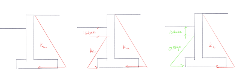

This question has been asked before on this website, and the consensus seems to be that you don't use passive pressure when checking retaining walls for overturning and soil bearing pressure. I'd like to pose a couple hypotheticals to get some opinions on the approach.
Let's say you have a building foundation wall that has negligible vertical loads on it, but it is acting as a retaining wall with exterior grade being lower than the interior floor by 3'-0". For case 1, you have you're bottom of footing at 2'-0" below the exterior grade (retaining 5'-0" on heel side). You neglect the passive pressure of the exterior soil, and that all seems to make sense. But how about for case 2, you instead have you're bottom of footing 4'-0" below the exterior grade (retaining 7'-0" on heel side). You will most likely end up needing a larger footing due to the overturning and soil bearing pressure checks even though the grading elevations haven't changed. Intuitively I feel like your footings should be the same size, but using a program like RetainPro that's not what you get.
One reason I've heard for neglecting passive pressure is because someone may excavate against the wall at a later date removing all of the passive pressure soil. If this is the reasoning why you neglect passive pressure, should you also be designing standard non-retaining foundation walls with neglecting the soil on one side which would create a retaining wall scenario? I assume most typical spread footing foundation walls would fail in that scenario. Why is it correct to design retaining walls as if there is no soil on the low side, but it is not correct to design standard stem walls that way?
For retaining walls, is there anything you can do to account for the fact that you have more or less soil on the toe side when doing overturning and soil bearing pressure checks(besides from the weight of the soil)?

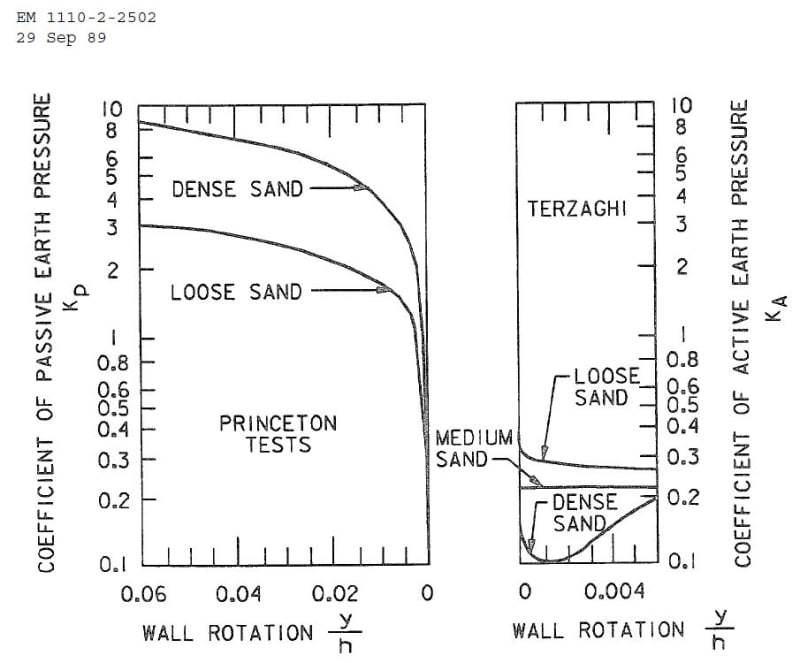

yes, you can use passive pressure and it is documented in Corps of Engineers "EM 1110-2-2502 RETAINING AND FLOOD WALLS", section 3-8. this reference limits it to 1/2 the passive in order to limit the amount of rotation.
"Development of the maximum possible horizontal stress, or passive pressure, requires much larger wall rotations than for the active case, as much as 0.02 to 0.2 radian. It should be noted that the deformation required to mobilize one-half of the passive pressure is significantly smaller than that required for full mobilization."
If you can accommodate the 0.02 to 0.2 radians rotation (from 1-5/8" up to 16" at the top of a 7' high wall), then sure, you can utilize some of the passive soil pressure to resist overturning. Seems as if it would be fairly impractical for most foundation walls.

HotRod10, how much a grade difference do you need on the two sides of a wall before you would consider it a retaining wall? Let's say I have a 4' tall wall that has 4' of soil on one side and 3'-6" on the other side (6" grade difference). Is this a retaining wall where you need to check it for overturning neglecting the passive pressure? What about 1'-0" grade difference? or 1'-6" or 2'-0"?
What I'm getting at is that in all of those scenarios the only difference on the overturning check would be varying weight of toe soil acting as a resisting moment. Assuming you have a small toe on your wall, this shouldn't make much of a difference and the overturning check on all cases should be the same. However, I imagine the greater the grade difference the greater there is a chance of overturning.
Do you know why all of those scenarios should have the same overturning check, but at some point when the grade difference is a negligible amount we can ignore lateral soils pressures all together?
however, half the passive requires significantly less rotation. (than 0.02 to 0.2 radians)
according to the figure below, the rotation is essentially nil at Kp=0.5

Is it acceptable to consider the at-rest or active pressure on the low side of a retaining wall to resist overturning when you do you're overturning and footing bearing pressure checks?
You would use the soil pressure appropriate to the level of compaction. The geotech guys can correct me if I'm wrong here, but my understanding is that if the backfill is not compacted, active pressure would be most appropriate, while at-rest pressure would be more appropriate for compacted fill.
Again, active, at-rest, or passive are all lateral soil pressure conditions, which do not affect bearing capacity. Overturning is only marginally affected by the resisting soil pressure. Usually, resisting soil pressure is only used in the sliding check, if it is used at all.
I understand that lateral soils pressures don't affect bearing capacity. I'm talking about the soil bearing pressure check that must include the moment that the lateral soil pressures cause (creates a trapezoidal or triangular bearing pressure distribution on the bottom of the footing).
I'm pretty sure the program I use for retaining wall design (RetainPro) does not include include resisting lateral soil pressures for the bearing pressure and the overturning checks. It sounds to me like it would be acceptable to include an active lateral pressure on the low side of the wall as a resisting moment for these two checks. But including it won't necessarily have much of an effect.

MJC6125:
At a sufficient buried depth it makes sense to consider an active pressure on the un-retained side of the wall, I believe there is actually a check box in one of the option menus for RetainPro to use the passive pressure for the stability checks.
As others noted to engage full passive takes some decent movement which you aren't likely to achieve in some of the scenarios you suggested where the footing is much lower than the retained height. In these instances you can either conservatively ignore the restoring soil and get a larger heel or conservatively use active pressure ignoring a reasonable depth from the top surface or use 0.5*passive and again ignore a reasonable depth from the top surface.

Active earth pressure is a driving force and not a resisting force. I've never seen active earth pressure used to provide wall stability at the front face of a wall or wall footing. Passive pressure can be used for overturning and sliding resistance but is often ignored for various reasons, as discussed above.
PEinc:
With large bury depths due to various reasons either bad soil layer, MEP coordination, influence zone etc. you get to a condition of competing driving forces rather than a driving and resisting. There comes a point where if you consider passive it actually fully overpowers the active pressure.
EDIT: In reality it becomes more of a pile analysis
Open Source Structural Applications:
Celt83, how can passive pressure "overpower" active pressure? Passive pressure is a resistance or reaction, not an applied driving force. It builds up only as needed or as capable; or it is insufficient to stabilize the wall and the wall moves toward the low side and fails. Passive pressure cannot push a wall backward. If it could, it would be active pressure (a driving force) and the pressure on the other side of the wall would become the passive resistance.

so in any condition where the passive soil side has an effective height greater than 0.531*retained height the passive pressure would by the numbers overpower the active pressure, per the chart posted by CVG this condition would result in very small movements and you would get to a condition where Kp approx. = Ka.
Edit: PEinc I think we are saying the same thing but as I usually do I am fumbling terminology, it is still a passive pressure but the movement is such that you are only mobilizing a fraction of the full passive value which may be nearly equivalent to the active pressure.
