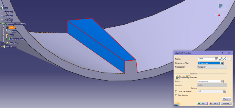

To illustrate, lets say I have a tapered cylindrical shell and I want to insert stiffeners.

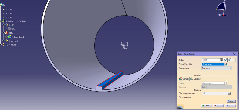

The red lines are the edges I want to fillet (highlighted in this image & the next)

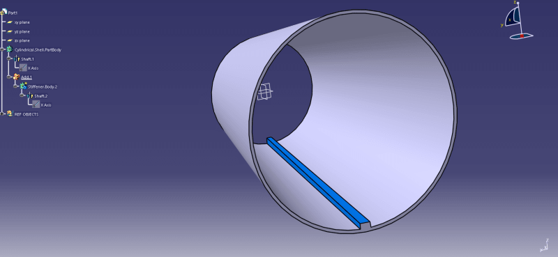

The model tree on the right shows that I have created stiffener in a separate body and added it to the original body.
Please suggest on how to proceed from here. I tried choosing "intersection" in propagation but for some reason Catia is not allowing me to choose "Shaft.2" as it is already absorbed by another feature or something like that...

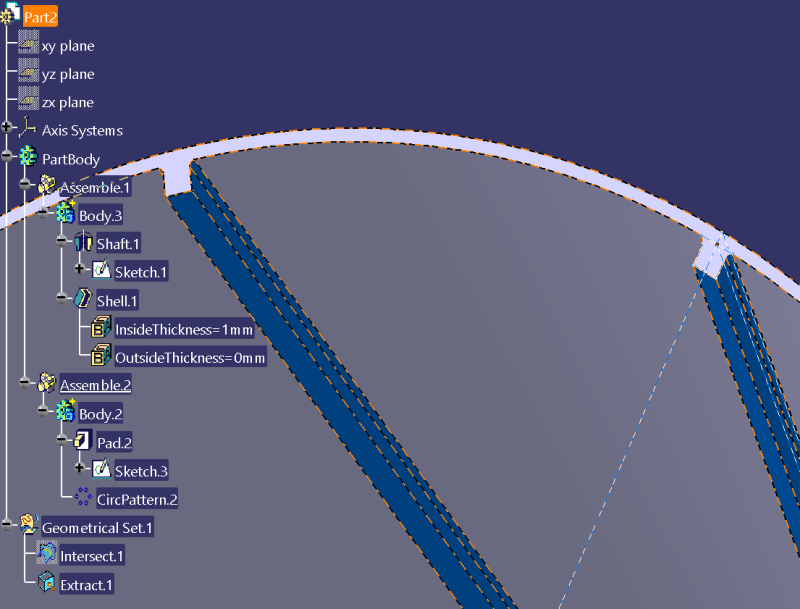

so, right click on your Shaft.1 and find the command "insert in New Body"
the two rib-fillets (longitudinal 2 edges and transverse 2 edges) need to be done manually with the larger ones first, in the rib body.
the pattern is done on the entire rib-body (complete crown)
the last edge-fillet is intersect one, point to the boolean Add.2 to get the desired result
