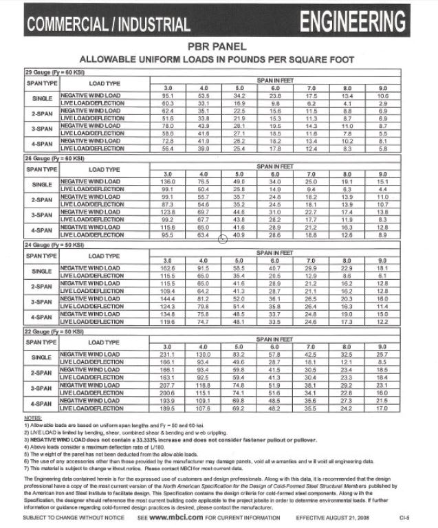

About wanting to do the calculations analytically, I would like to know how far are each supplier from the "real behavior" of the panel, because I can notice that for the same profile section with the same steel grade and also the same thicknesses they have quite different values.
See the images that I attach below, and let me know your thoughts.

It seems odd that the 26 gauge panels for a single span are rated higher than 24 gauge. That needs to be affirmed by the supplier of the panels.
Fy and Fu are claimed to be 60 and 61.5 ksi respectively for the 26 gauge material. Seems high.
Modulus of elasticity, 'E' was not given, but it usually does not vary much, regardless of Fy.
Are such flimsy panels really used up to spans of 9'-0"?

I agree that the charts look off because they show the 26 Ga. panels as stronger than the 24 Ga. panels for simple span.
When people choose to do a through fastened roof like PBR (I have no idea why anyone would want a million holes in their roof) 24 Ga. is standard. 26 Ga. used to be more common but it doesn't work well for more recent codes. In any case on a PEMB, the max purlin spacing on a roof would be 5 ft but are typically less than that.
26 Ga. panels are more common for walls where the C&C loads are smaller.
29 Ga. panels are only used as liner panels. That's where you have a thicker panel on the outside of your girts but want metal sheeting on the inside of your building in lieu of leaving it open or doing drywall or whatever.

Take a look again and notice that gauge 26 is fy 60 ksi, and gauge 24 is 50 ksi, so maybe for the differente of fy can be the difference of behavior. Maybe depending if it is a single span where you just have the top part of the panel in compression or multispan where the maximum bending moment you have it at support and compressions can be in bottom part of the panel can provoke those difference, that's why I want to calculate it.
And about the distance of 9', for PEMB , I think you put this maximum distance in walls, because in the walls, as you have less load than roof, you can achieve this separation for girts. In the roofs as SandwichEngine says, maximum is usually 5' because these panels of 1 - 1/4" depth can not hold the load needed at more length than that.

I was aware of the difference in Fy and Fu (60 & 61.5 ksi vs 50 & 60 ksi) for 26 ga. vs. 24 and 22 ga. panels respectively, but a ratio of Fu/Fy of 1.025 seems unusually low for steel, so I suggest you ask the supplier to confirm those values. I do not believe them.
For strength calculations of the panels, see Note 1 below the load tables.

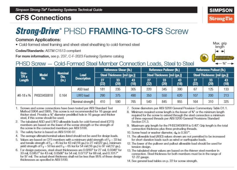

There are many types of self drilling screws. Values of shear, pullover and pullout are determined by test. The Simpson Strong-Tie chart below provides values for one particular screw, but 22 ga. is the maximum panel thickness considered. For lighter gauge material, you may wish to look at the standard referenced in Note 2. I am not familiar with it.

From my guess point of view, I noticed that the 26/60, the material is not 60 ksi, in reality is 80 ksi, but they limit to 60 ksi. So limitating the Fu to 61,5 ksi it can be a way to reduces also the capacity of the material in pose of the safety. That would explain the difference between the 24/50 and 26/60, because the tables are limited not only by strength but also for deflections. So maybe when they are by strength the code can allow for the parts of the panel which works in tension to achieve the Fu and for the compression ones to achieve just Fy.

I came across some other tables for PBR panels (see below). The values for 26 gauge panels seem to be in close agreement with your values, but I have not done a rigorous comparison of the two sets of tables, nor have I attempted to check the calculations using normal principles. The tables below list Fy as 60 ksi for 29 and 26 gauge panels. I would not assume Fy = 80 ksi for any panel without a guarantee that it is so.
