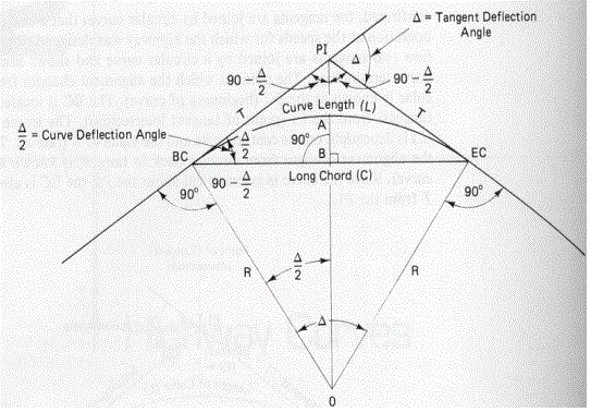

I'm working on studying for my PE, but one of my practice exam questions is confusing me, even with the answer worked in the back. I think they forgot to multiple by 2, which is pretty bad for a reference practice exam. Maybe you can direct me to my mistake:

I understand that the station is just 1240', and the Degree of Curvature, D, is the degree the curve sweeps over a chord/arc length of 100'. I also found online (and was able to convince myself this was correct) that the Deflection Angle is equal to the intersection angle divided by 2, the intersection angle being the total angle the curve must sweep from PC to PT, so the answer is basically just:
Length of curve = [Total sweep angle]/[sweep angle per 100'] = 2*[Deflection Angle]/[degree of curve] * 100' = (2*12.5/10)*100' = 250'
Station PC = PI - L/2 = 1240 - 250/2 = 1115
Station PT = PC + L = 1115 + 250 = 1365'
The final answer is 13+65.00
The available options are 12+80, 13+2, or 13+65. The answer in the back doesn't multiple the Delfection Angle by 2, gets a curve lenght of 125' and the station at 13+2. Based on everything I can find, that's wrong.

This site has "tangent deflection angle" and "curve deflection angle" which differ by a factor of two. You only have "deflection angle"... That said, presumably tangent deflection angle is the main one since it gets a symbol.

This all just seems to be a large terminology misunderstanding. Based on steveh49's image, I would say that 12.5° is the TANGENT angle (as it's the one with a symbol given). But I found multiple references, this one being the most clear (
) that specifically states the DEFLECTION ANGLE (DC) is the angle for the full curve from the point PT or PC (which is half the DELTA or the TOTAL INTERSECTION ANGLE, aka Δ/2), while the typical use for DELFECTION ANGLEs (dc, lowercase) is for the angle between tangents at any given points on the curve, the DC being the maximum possible dc.
Based on this terminology, I would multiple the 12.5° by 2 to get the full intersection angle.
