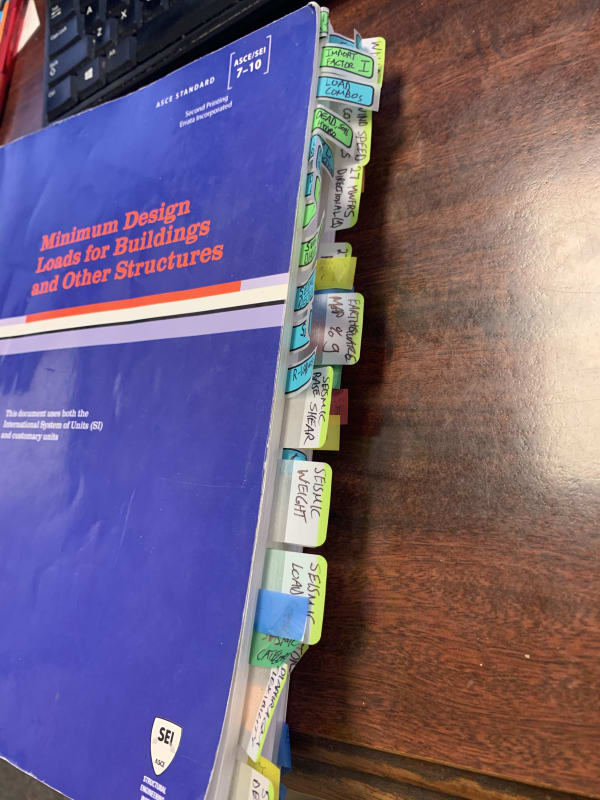

Study ASCE 7 and CERM thoroughly. Your book should look like a tab forest by the time you're done, like mine lol. Then create a topic-based index so you can find relevant sections quickly. I've attached the one I made for the exam in 2017.
