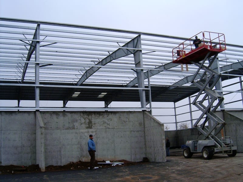

I am trying to come up with a fee proposal for a Waste Transfer Station. The job is basically a pre-engineered metal building foundation. But I noticed that they have what is called a "push wall". I did some research and I understand what it is.
Looking at the preliminary layout drawings, it almost seems that the PEMB columns must bear on top of the concrete push wall. Is this normal? From my research it seems that the PEMB columns are usually outboard of the push wall, and the foundations for each are separate entities. Are they ever constructed with the columns bearing on top of the wall?
Below is a picture that I found online. ANd below that is a screen shot of the preliminary drawing elevation. I will ask the architect for clarity - but I wanted to run it by you all to make sure this isn't a "stupid question".
I haven't done one with a push wall before, however my thoughts are as follows:
1. Dealing with thrust from the PEMB is going to be a pain, most likely requiring pilasters.
2. Setting the columns outboard would simplify the project significantly for you, however I'm not sure if it would be cheaper to build.
3. My fee for this would be significantly more than a normal PEMB foundation and probably more than if I had just designed the whole structure myself conventionally.
4. PEMB anchorage to the wall will be difficult.
5. Definitely not a stupid question, they need to understand the impacts of placing the PEMB on top of the wall, from anchorage to thrust concerns. You will also need to know what the "push load" is as I assume this means they are pushing grains against the walls, so it's in essence a retaining wall with impact loading?
I think it is a good question. But I believe it will be more efficient to put the building columns on top of the push wall. I am not sure it is possible to have separate footings for the columns versus the push wall - the push wall is a cantilever wall with a large horizontal load at the top, so it will have a wide continuous footing.

I've done a few of these buildings with the PEMB columns on top of the concrete wall. We design piers inside the wall, as if the wall doesn't exist. We also take the thrust all the way to the footing and design the footing for the OT moment.
As for the push wall itself, we design it for the horizontal pressure due to the grain load (or manure, whatever's in your building). We do NOT design the wall for the front end loader to load the wall via pushing. If that's what's going to happen, well, thicken your wall accordingly. :-)

As Aesur and DaveAtkins propose, we used pilasters to handle the thrust and anchor the PEMB on top of the CIP wall.

I used the maximum hydraulic capacity of the bucket. The manufacturer literature usually shows that. As I recall, I considered it an ultimate load. I know I spread it at 45 degree angles down the height of the wall.
