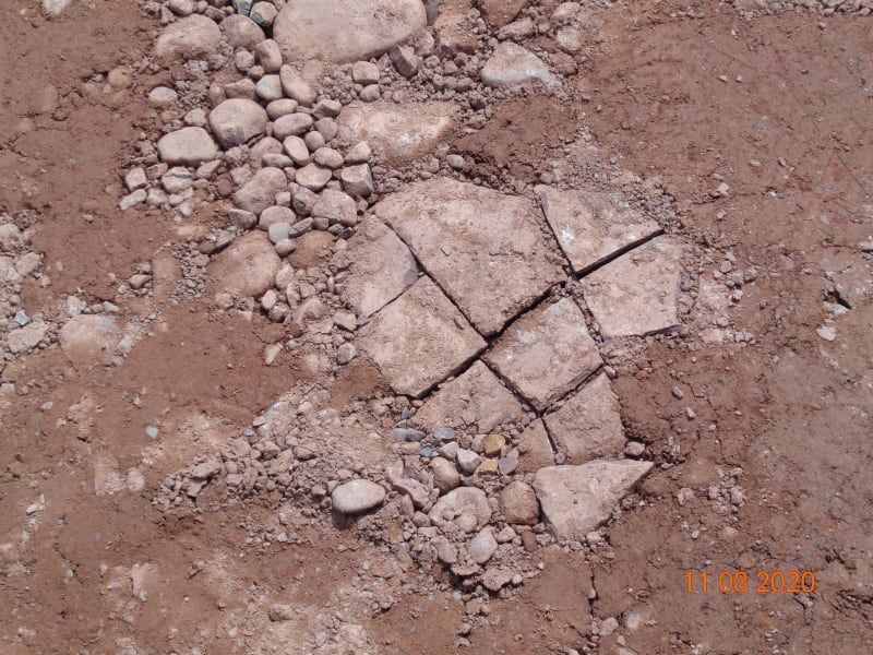

There is very interesting issue on a recent project. Somewhere, although it is not in the project requirements, the client has it in his mind that a rockfill (alluvium) where the 400-700 mm boulders are crushed in a jaw crusher and then reintegrated into the minus 400 mm material, can have no more than 17% of the material being "crushed". (not 15%; not 20% but 17%!). This material is in the outer shells of the embankment dam upstream and downstream.
Has anyone ever run into a similar "requirement" or "notion"?? I haven't. Just wondering as we have many engineers from a great many countries following this forum.

GeoEnvGuy - Don't think so - I think it might be a "Russian" thing. The alluvium fill will be subjected to, at the base, fill heights of up to 300 m or so. They are worried, I think, in that crushing of angular particles or microfractures within the crushed 400-700 mm breaking off, and causing, perhaps, more settlement that if the crushed material was not present. The natural alluvium contains a number of different rock types and an observable portion of the boulders are angular to subangular. We have found that the boulders at the surface of the fill layer, as a result of placing (dozer) and compaction (smooth steel drum vibratory roller) do in some cases show "platelike" and "block-like" fractures.
