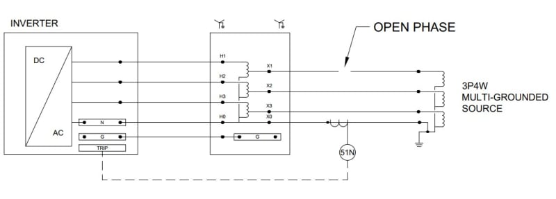

Do you think the below scheme would work for phase loss detection? It might also provide some ground fault protection but that is not the point. The inverter shown is a voltage-controlled current source with high Z1 such that I_LLL is on the order of 1.5pu. The inverter neutral is for sensing only and Z0 is effectively infinite.
