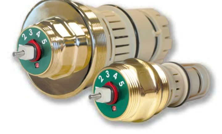

As you may know pressure independent valves(PICV) have a dial on themselves to adjust maximum flow according to the load characteristic, it is in fact a balancing valve sitted inside the PICV
Now my question is that what will happen if I adjust it uncorrectly, higher or lower value than the load, suppose it is a fan coil controlled with PICV
Will the valve not correct adjusting affect the fan coil performance or not?

The dial is limiting the maximum flow from the load by narrowing the space of the valve cartridge
Does bad setting of the maximum flow affect the room temperature control or it doesn't?

The cartridge of the valve is like below.
Sounds like you have a modulating actuator and the PICV have a preset for the flow. Each of the numbers represents a flowrate (I wish they would write that on, but yo have to look that up int he spec sheet). Also sounds like your FCU is just on/off. So when heat is needed, the fan starts and the valve opens 100%.
to have the design capacity, the water flow needs to be at or slightly above the design flowrate. So you need to set it close to that. So check the FCU schedule what flow is needed. The designer should provide that info. If too little flow, you lose some capacity (i.e. air will be colder), if too much flow, your dT will be low and you waste pump power. It is not different from any other type of valve.
Of course, setting it wrong will have negative impact. Assuming the valve is in series to the coil, the flow of the coil will equal flow through the valve. I don't see a real scenario where the flows would differ.. that is what a control valve does.

I decreased the flow by closing a ball valve more befor the picv valve. And the problem mitigated so
Do you think it is more related to the bad adjusting the valve's maximum flowrate or it has nothing to do at all.
It would be appreciated to correlate the flowrate setting according to the case what I mentioned.
