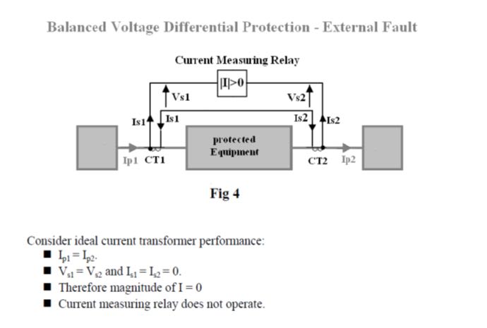

Pilot wire impedance
Cerkit
Jan 18, 2016
100
GB
I am calculating the voltage and current flowing in pilot wires in a voltage balance protection system. The literature I am reading says that for an external fault the impedance seen is half the open circuit impedance of the pilots. Does this mean that no current flows for an external fault?
See:
