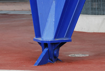

I am designing a moment frame to support a heavy ductile iron pipe. I have designed it as an intermediate moment frame with pin base columns. I am not able to deliver the uplift with over strength factor to the foundation with epoxy anchors set within the column flanges (typical pin base connection detail). Ideally, I would like to cast-in-place the bolts in a new footing, but due to some site constraints I have to go with with epoxy anchors in existing 17" thick slab. Is it an acceptable practice to set the anchor bolts outside the flange (detail similar to a moment base column) for this case. I need a bigger breakout cone for the anchors which can be done by setting the anchor bolts outside the flanges. Any other suggestions are welcome, thanks!

Firstly, if you want a ductile moment frame then I think the only acceptable type of base detail is a genuine pin consisting of a single large greased rod that truly cannot take rotation
Otherwise, any form of base detailing involving epoxied or cast in bolts will lead to moment generated at the base which will affect your design

Perhaps you could fabricate a bracket that you bolt down that supports a pin connection to take shear and uplift only that you then bolt on site to the portal leg
See the link below for some ideas of what I'm meaning

If you really NEED a pin connection then it should be detailed as such:
Thanks everyone for the feedback. I ended up with cast-in-place anchors and baseplate assembly set on a new footing on top of the existing concrete slab, thereby eliminating the need for epoxy anchors.
