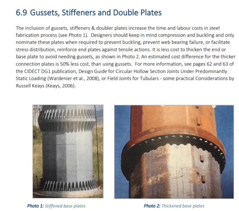

How often to you need to gusset those baseplates? I realize this is a function of demand, but I'm curious where you draw the line between a thick baseplate and the need for gussets.
Never. (I've used up to 60mm thick plates to avoid gussets. 170kg, 375 pounds per base plate)
Gusseted base plates should be avoided if you can. They are expensive. There are numerous resources that advise this. And it is certainly the case if I talk to my local fabricators.
I'm sure there are many cases where they really are needed once the size of the welds get completely unmanageable. But generally thick places with multipass fillets are easy and cheap solutions.
