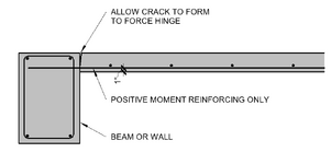

I have a question about elevated concrete slab design/detailing. Does the condition shown below meet the requirements of ACI? Can shear friction account for the shear transfer across the cracked joint? The goal is to assume a hinge for analysis purposes. Does the direct interaction of concrete below the reinforcing develop a negative moment? If so would the shear depth of the slab for shear capacity then be 1"?

I'm not that familiar with ACI, but I would not detail it like that.
I feel like RC design is often thought of as "elastic" design, but it really requires you to think in plastic terms, or at least consider the cracking.
I would add a hairpin to connect the beam and slab (that is how it's done in my area)... in other words I'd deffinitely have top reinforcement. The question is "what is a hinge"? It is theoretically a connection that transfers 0 moment and has infinite rotation capacity. In reality anything that transfers a small moment and rotates a lot is good enough to be considered a hinge. In Eurocode this is solved like this "consider the connection pinned, but add at least 25 % of bottom reinforcement to the top of the slab".
The point is this - you are designing for ULS, so you're supposed to model the structure in that condition. If you add minimum reinforcement to the top what will happen? When the load is very small it will act as a fully fixed joint. Increase the load and at one point top reinforcement will start to yield. What happens when you increase the load further? That section still transmits the same (small) negative moment and starts rotating, but positive moment at the middle of the slab span increases. So, from yielding of the top reinforcement until failure of the slab it will deffinitely be a hinge. Theoretically you could "reduce" the midspan moment because of that small moment at the edge, but why bother?
NO ! .. You are expected to provide at leat min . top reinf.
The goal is to assume a hinge for analysis purposes..
If the slab supported on end beam ( the slab is not continuous ) . You can model simply supported although the beam will resist with torsion but will be negligible . If the side support is a wall , in this case the slab can be assumed continuous if there is no cold joint btw slab and wall .
If exterior support is a beam , it is common practice to assume simply supported slab and provide top reinf. at least 50% of span reinf.

I’m trying to make this point in an internal debate. I agree that this detail is not a good detail, but I am having a hard time putting the code references together. ACI seems pretty explicit about top reinforcement for two-way slabs but the one-way slabs section doesn’t refer to those detailing requirements (that I have found).

We are very different time zones and i just see your respond . You can follow and adapt two way slab detailing rules or you may look ACI Detailing Manual. The following is excerpt form the manual .

Eliminating the top bars at the exterior support is a bad idea. What you illustrated in your detail (a crack where the slab connects to the beam) is a serious flaw and an ACI 318 code violation. In addition to compromising shear strength, what owner is going be ok with a continuous crack like that? Also, omitting those bars is contrary to accepted standard industry practice. So, when the matter is settled in court, you and your insurance company will be paying for the repairs – which will be more than just “gluing” it back together via epoxy injection.
I suggest assuming the connection is pinned, but detailing it with minimum top steel as shown in HTURKAK's illustration.

It’s a bad idea. While there are cases where introducing pin joints is appropriate, this situation doesn’t call for it—and even if it did, this isn’t the best way to implement one. It could lead to a noticeable crack with uncertain shear capacity. Any peer reviewer called to assess the crack won’t like it.

Any engineer who does not understand that the detail (no top steel at the slab-to-beam connection) is a bad idea is probably suffering from the Dunning-Kruger effect and probably won’t understand why it’s a bad detail. Is the person you are trying to convince a structural engineer?!
Tell them that because the slab will be poured monolithic with the beam, there will some (albeit small) negative moment at the slab-to-beam connection, and ACI 318 prohibits the use of plain concrete to resist the negative moment (no matter how small). Therefore, the slab will crack, the severity and exact location of the crack will be uncertain, and there will be insufficient shear strength at the crack. And if there is not enough shear strength at the connection there will be a structural failure.
