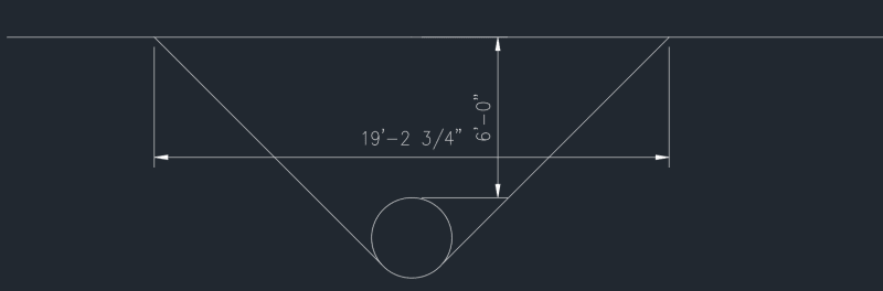

I have been asked to design a temporary construction 'Air Bridge' spanning over a 36" pipeline.
The pipeline owner specifies a minimum 6" airspace; and our span will be 13ft.

Correct, the pipeline is buried. It is a 36" gas pipeline owned by Kinder Morgan. We had the pipe surveyed and it is 6ft below natural grade where we need to cross it.
Kinder Morgan has suggested details for pipeline crossings. But for loads greater than an HS-25 truck, they require a sealed set of plans + calcs for the temporary crossing.
Attached is their suggested detail.

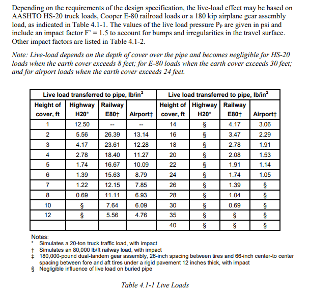

This is all trying to solve a problem which doesn't exist. People have been driving things over pipelines for centuries without all these air bridges. Pipeline codes and standards have this sorted.
See this e.g.
Search on heavy pipeline crossing.
At 6 feet down you really don't have an issue. You can bet KM don't do this when they're working over their own pipelines.....
Concentrating the loads on those main supports creates more issues than spreading it over a wider area
Very good reference. This is enough for me.
Good reference LittleInch. Sure does help to put it in perspective.
