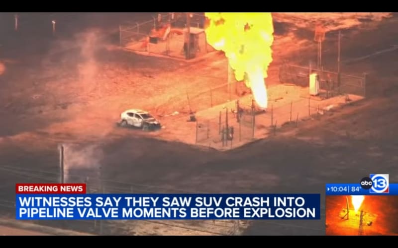

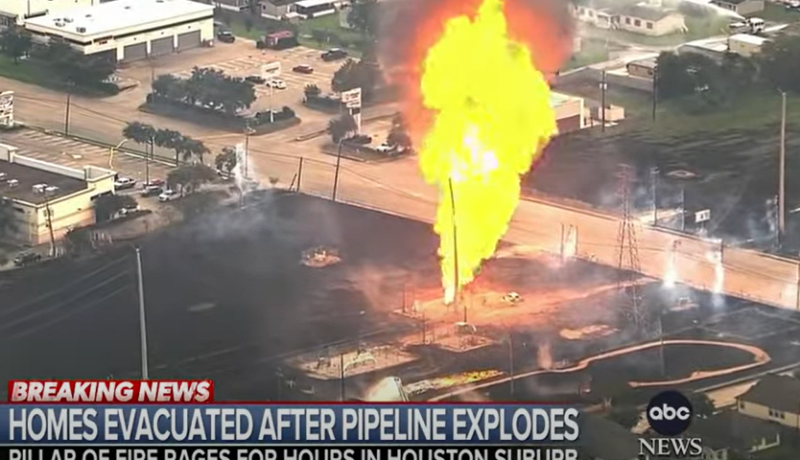

This was quite the hot topic for those of us in the Houston area yesterday:
La Porte Pipeline Explosion
It ended up being a case of an out of control car from the adjacent Wal-Mart parking lot drove into the right-of-way, crashed through the enclosure fence, and broke the line.
It made for an impressive sight. ABC News Video Story

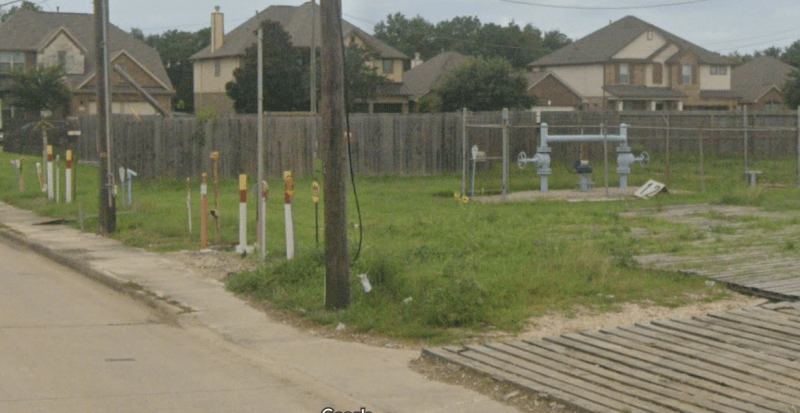

I'm sure the pipeline companies are going to reevaluate how they secure these valve stations near populated areas. While street view shows that the right-of-way was pretty well protected by bollards and heavy fencing from the adjacent Spencer Highway, there really wasn't anything similar along the shopping center parking lot side.

Hmmm, interesting - I think that's actually an NGL - line - condensate or possibly propane / butane hence why its so yellow.

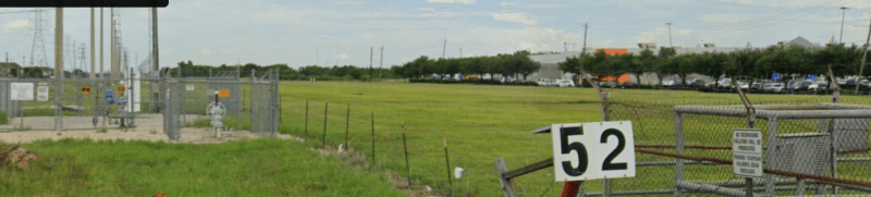

The walmart site is 70m away and has a field between the two.
This is the same strip and I would hardly call this well protected by bollards.... There are a lot of pipeline markers, but they are flimsy and not protective.
Even so I think that would not come up as a risk where it was.
I'm pretty sure its the blue valve which has got knocked off and you can see the field between it and walmart.
Still pretty impressive "tower of fire".
Bet they put in proper vehicle guardrails this time.

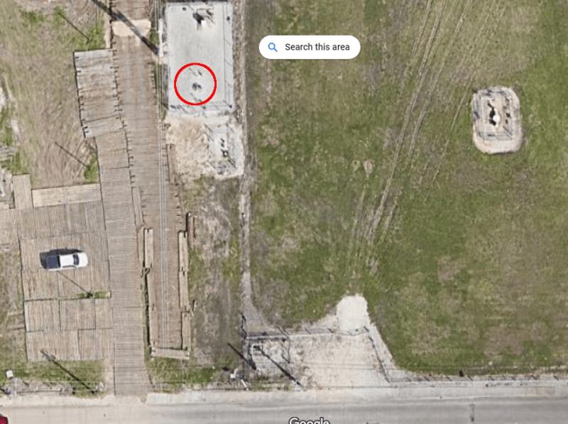

I don't see any adjacent Walmart parking lot!
It's the other side of the next field!
It would be getting into the very unlikely risk level....
Yes. Very extremely unlikely.

There probably isn't enough verifiable information to identify the driver. Looking at how far from car the power poles are that are smoldering from the radiant heat, I'd say no one wants to get close enough to read the remaining license plate.

How? The fence closest to walmart is untouched. The damaged fence section is the south west corner.

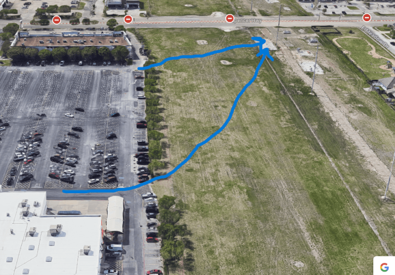

Sounds like it accelerated across the empty bit, hit a bump or berm, took off, jumped the fence and landed on the valve before stopping whet it is now. I suspect the driver didn't make it.

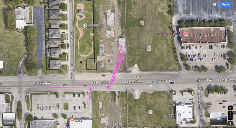

I think the pressure from the escaping gas flipped the car back along the original path to where it is now. This is an older photo; I don't see the temporary roadway lumber in the current fire photos. In this case it was a path from lower left to upper right, heading approx NNE.

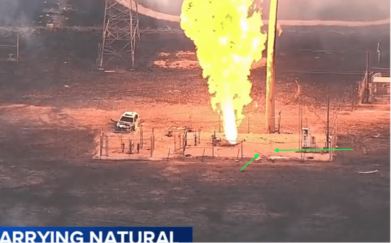

That is my thoughts as well. It is logical that impact sent car back from where it came..... ? However, see last photo indicating perhaps it did take out fence post from WalMart Direction?
Oops, update image....
However, this image looks like a fence post has been taken out and is laying on the ground in direction of travel from WalMart?

Ooops 409 - this is the opposite angel view. The white building is Walmart. It would seem feasible if the person had an attack of some sort or the old accelerator / brake confusion and just gunned it at the bottom road they could go through the small fence and then head straight for the pipeline valves.
Wow, that video of the crash is impressive. The eye witness report from earlier suggest the driver had some kind of medical incident and ended up flooring the accelerator. It was definitely moving fast in that video clip.
