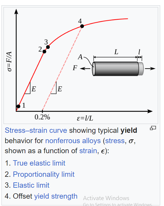

The 0.2% strain criterion is used for determining yielding under uniaxial stress in ductile metals. Yielding refers to the condition when a significant plastic deformation occurs.
The von Mises failure criterion refers to failure under multiaxial stress conditions when the distortion strain energy under failure condition becomes equivalent to uniaxial or any other stress state under failure conditions.
If we take uniaxial stress, the limit is yield stress (0.2% strain criterion). So the equivalent to uniaxial failure is when the von Mises stress becomes equal to uniaxial yield stress.
So the 0.2% strain criterion is used only for determining failure in uniaxial stress conditions as we perform a tensile stress in a machine.

Regarding "this doesn't exceed 2% of Young's Modulus,", this is not accurate, refer stress-strain curve below:
The curve at 0.2% strain point may not be in the linear part of the curve. So the 0.2% of Young's modulus concept may not be accurate.

Second, I see the flaw in my original thought logic, which is primarily that Hooke's law applies only to the linear portion of the stress-strain curve (usually assumed to around 0.2% strain). After which, the stress-strain relationship is non-linear and therefore Hooke's law cannot be applied. In order to determine strain exceeding 0.2% a different methodology (aka not Hooke's law) would need to be used.
