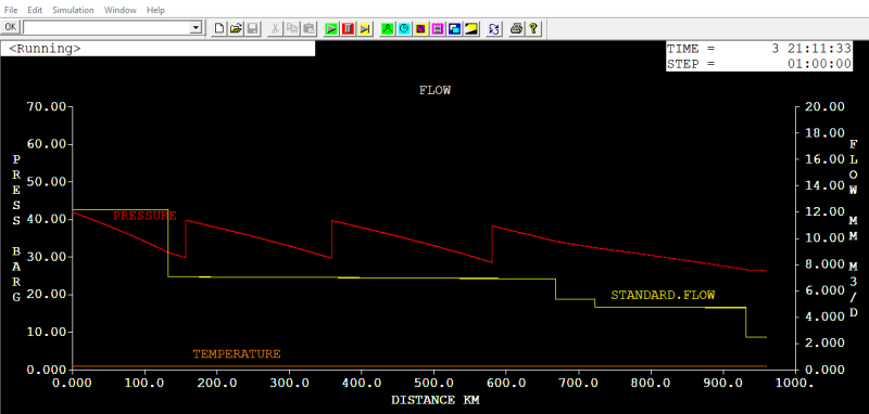

A pipeline I worked on a few years ago in Kazakhstan.
950 km long 30" (720mm) Diameter, 4 compressor stations 10-7-5-2.5 Million M3/day when in low pressure (40Barg) mode.
