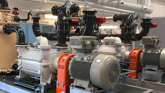

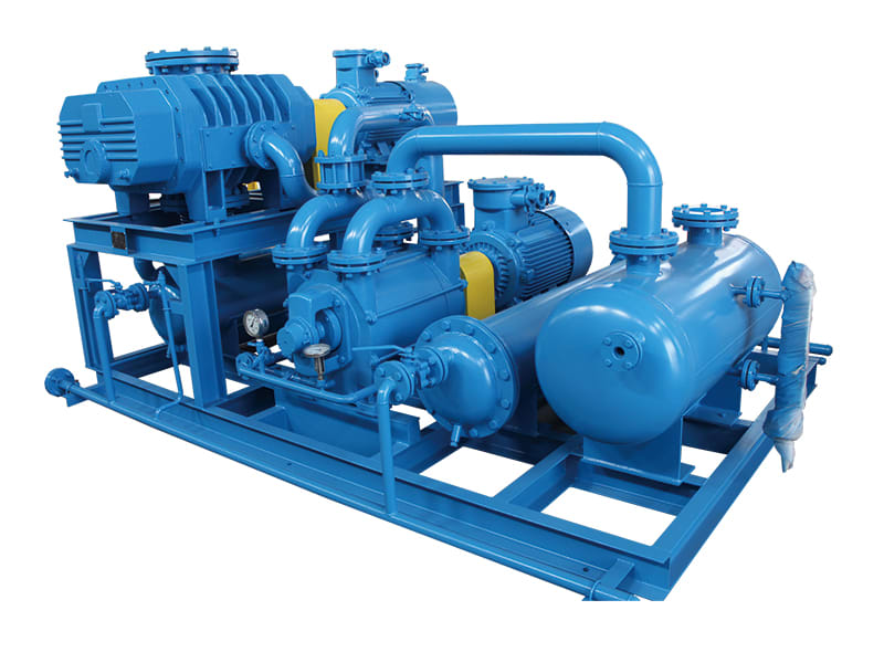

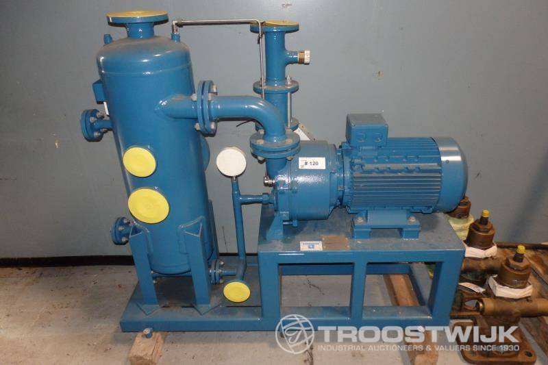

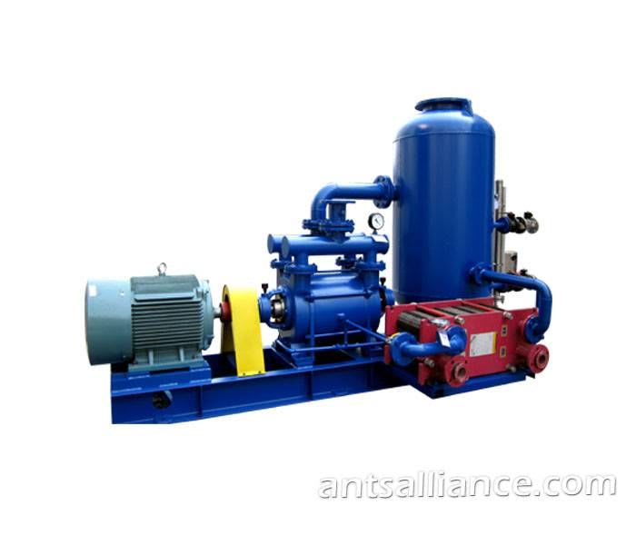

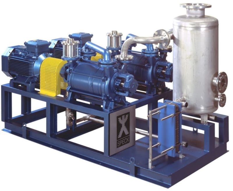

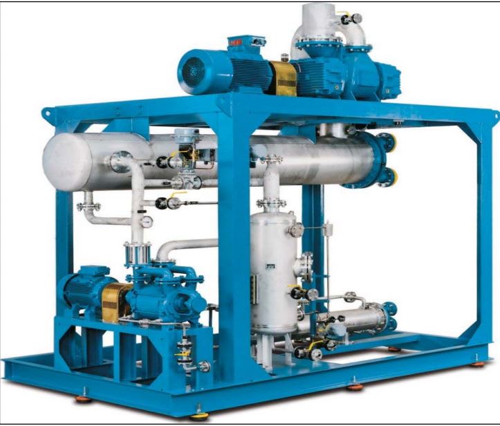

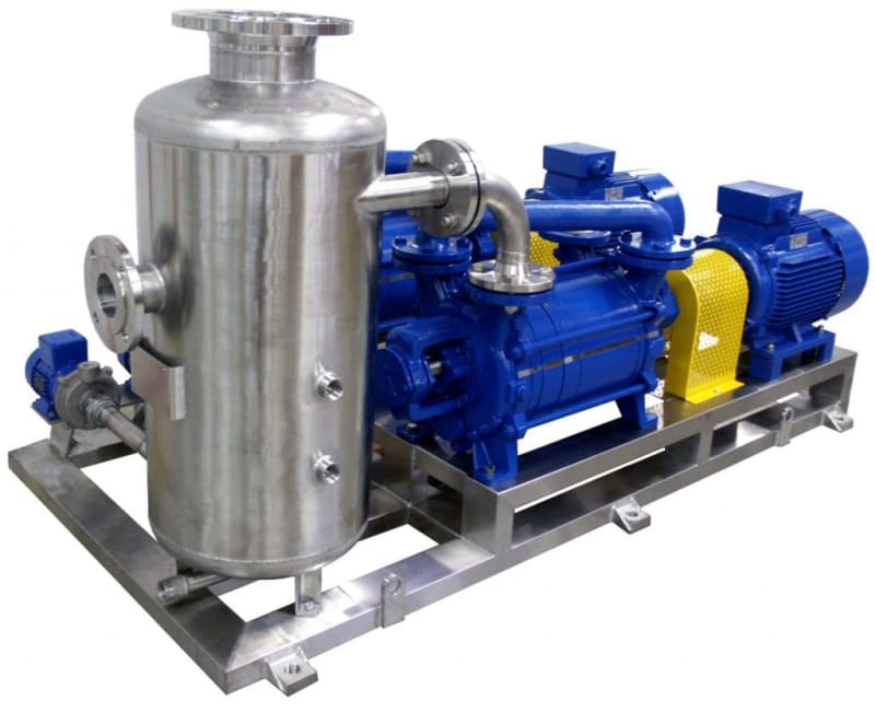

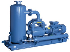

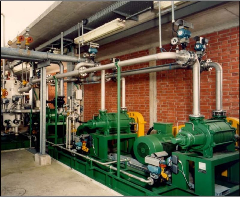

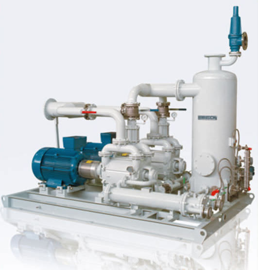

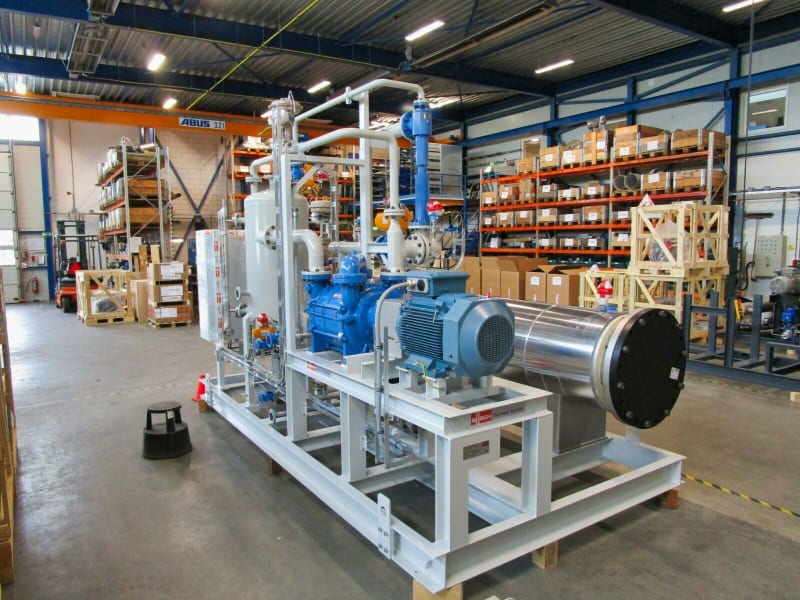

Sure, please find attached some examples from google..
Have a look on the discharge pipes between pump and vessel.
I see what you mean. Perhaps the manufacturers use B31.3 para 319.4.1(a), and possibly (b) to 'judge' their system satisfies B31.3 requirements for flexibility. Although I would argue that most manufacturers dont see the result of 20 yrs lifetime for the piping systems they design, hence cant (always) use that section of B31.3 for jusitification.
