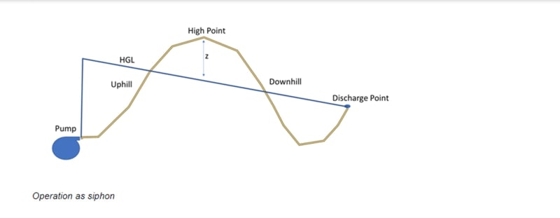

The condition you describe may occur if your system is working as a siphon.
The figure shows the pipeline operating as a siphon. This may work if z is very small. In areas where the pipe is above the hydraulic grade line (HGL), the pressures are negative; something that is not allowed in potable water distribution piping. But there are some problems with this design. First, is the flow sufficiently large and the downhill pipe slope sufficiently flat that the pipe will flow full? If the downhill slope is small or the flows low, the pipe will never reach full flow and siphon will not be established. Second, if z is greater than 32 ft (9.2 m), the liquid water will be below the vapor pressure of water and the siphon will never form. Third, even if the siphon works, eventually gases will collect at the high point and reduce the pipe capacity.
If the pipeline is not flowing full, then a single pump would have to have to lift the fluid to a pressure equal to the highest point.
