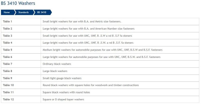

WHAT IS THE DIFFERENCE BETWEEN FORM A, B ETC WASHERS AND TABLE 3, 4, 7, 8
SOMETIMES A TABLE IS SPECIFIED WHILE SOMETIMES A FORM IS SPECIFIED, ALL VERY CONFUSING

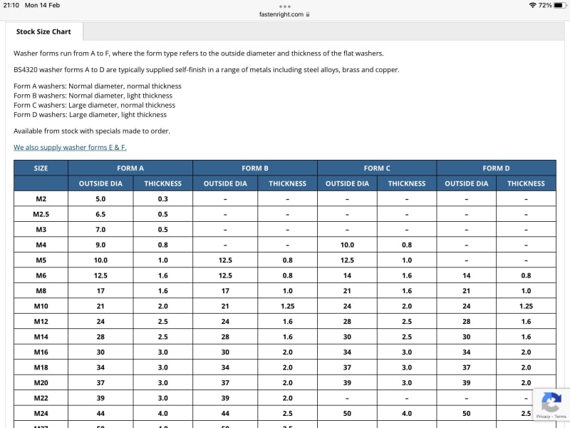

Hi davet1948
I may of misunderstood your question but above the table on the link I posted it gives the differences of the forms A,B,C,D in terms of outside diameter and thickness etc

No I didnt misunderstand your post, my post was what is the difference between the two specs.
Now with Rputvin's post we have the Tabe specs
Many thanks to all

Firstly I said :- "I might havr misunderstood your post" I never said you misunderstood mine.
Your question was what was the diference between form A.B.C. D washers, where in your question does it mention any washer specifications BS3410 BS4310?
Had you mentioned them in your original post I might have answered differently, quoting a TABLE 3,4,7,8 doesnt tell me the specifications.
