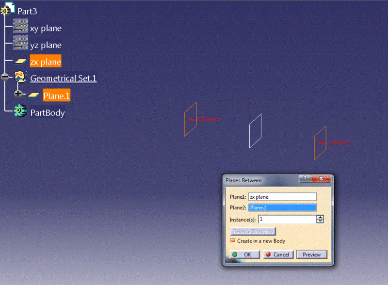

That is not what he asked for, and it is not associative to the two existing planes, as the number of planes will not be stored in the feature.
He wants to add a number of planes between two existing planes where the distance between the individual planes will be equally and associative distributed, depending on the distance between the two existing planes and the number of planes desired.
There is no Datum-plane function in NX11 which will do this.
The best option would be to create a Pattern feature for it. I have attached a small example. Take a look at the expressions used in the pattern and in the expression editor.
If you change the Nr_Of_Planes expression it will adapt the Pattern to it.

Catia has this option:
