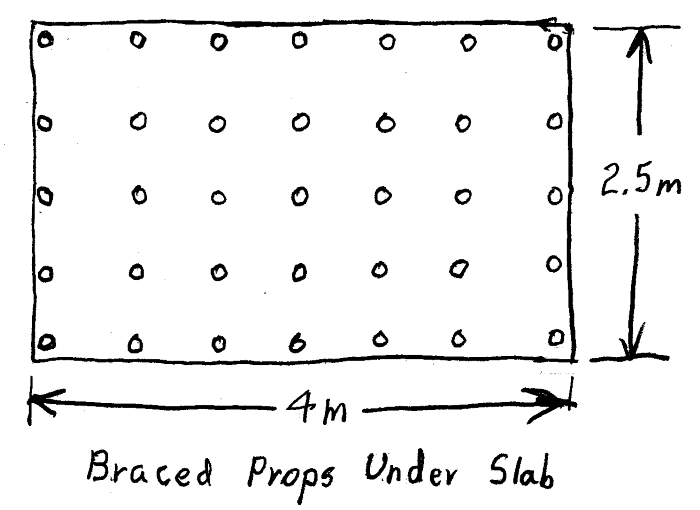

This what I have in mind, I will support the slab with formwork supported by braced steel props 50-70 cm apart,
After the concrete is taken apart and the rebar cut, remains will be taken off the formwork by hand off site.
TarikHKJ - It is not wise for us to tell you how to do this project. But we can give you some points to consider.
As I understand the project, slab #1 (labeled in the photo) is to be removed.
The braced props will bear on landing #3 and and stairs.
Your proposal is to demolish the temporarily supported reinforced concrete before removing any of it.
The braced props will fill the entire stairwell (see my sketch below) and will have to support the entire weight of slab #1 (approximately 6000 kg) plus a reasonable construction load. Also, may be some impact when existing rebar are cut.
1. Will landing #3 and the stairs support this loading?
2. The braced props will make access to the work area (from ground level) very difficult. Since a crane cannot be used, I assume there is no access from above. How will the work area be accessed and concrete debris be removed?
[idea]
[r2d2]
1: The landing and the stairs were designed to live load 5.5 kN/m2 and dead load 2 kN/m2, using this load combination Pu=1.2DL + 1.6LL
The weight of the slab+formork+equipment is approximately 9 kN/m2 on the stairs and landing
2:there is another access point.
