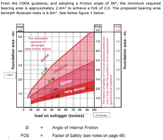

What are the ground conditions beneath the road build up? If they are granular then you should be able to make it work with some spreader mats. I have used Nylacast mats before. This was a 71 tonne crane which applied 12tonnes/m2 (120kPa) per outrigger on a 3 x 2m mat.
We confirmed that it worked.
