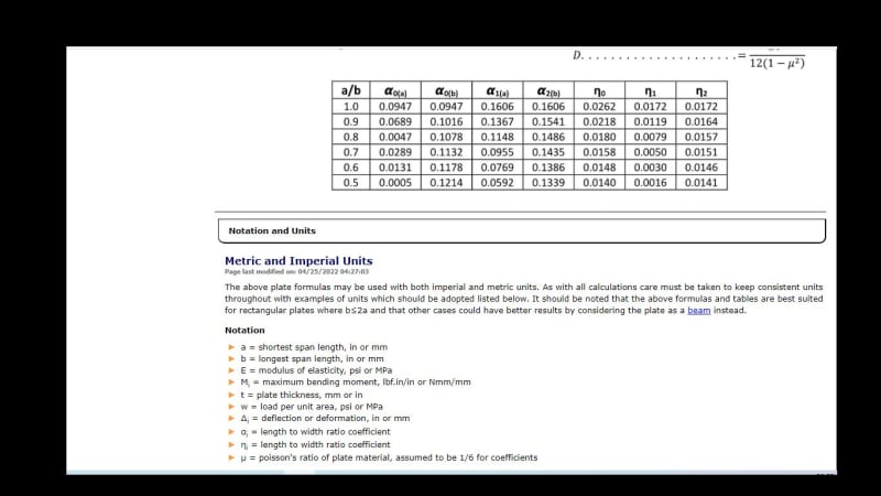

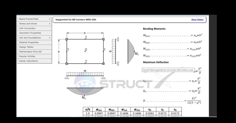

Good morning,
I've been trying to find the right formulas, for a plate that is going to be simple supported at the corners.
the only reference I've found online (not even Roark has the condition) is a webpage structX.
see screen shot attached, my question is, to what extent are the Moment formulas correct?
am I missing something, or the moment formulas are missing some units if W = psi and b^2 = inch^2 and alpha = dimensionless then Moment = lb....
I would bet the W is in plf or lbs/in based on the entire plate width
I agree w is probably psi, but I think their moments are moments/inch

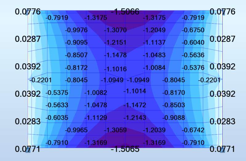

The table seems close I just ran a quick 10ft x 10ft 1" thick ASTM A36 plate with 100 psf loading
a=b=120 in
a2=b2=14400in2
w = 100 lbs/ft2 * 1ft2/144 in2 = 0.69444... psi
Mo(b) = 0.0947 * 14400 in2 * 0.6944... psi = 947 lb*in/in
Mo(b),fem = 1.0949 ft-kip/ft * 1000 lbs/kip * 12 in/ft * 1 ft / 12 in = 1094.9 lb*in/in
approx. error = (1094.9 - 947 / 1094.9) * 100 = 13.5%
M2(b) = 0.1606 * 14400 in2 * 0.6944... psi = 1605.9 lb*in/in
M2(b),fem = 1.5065 ft-kip/ft = 1506.5 lb*in/in
approx. error = 6.6%
And just design the entire plate on a per inch width basis, that actually makes much more sense.
@rb1957 & @Celt83 Moment, in lb*in/in, does it means, that at X=0 Moment = 0, and @ X=L/2 (Center) Moment = Value Calculated (in lb*in/in) * L/2 (in inch) = Max Moment at center in lb*in?????
BTW thanks all for the responses, this forum is the best ever!!!!!!!!!
Recommend this free lecture series: Link
I believe the associated textbook used to be a free download but I'm not able to locate the link currently.
moment per inch means your section modulus is 6/t^2 as opposed to 6/(Wt^2) ...
ie stress = 6*M/t^2
Dear vlad1981 (Civil/Environmental)(OP),
When you look to the bottom of the page , you will see the notation and the units..
Notation
a = shortest span length, in or mm
b = longest span length, in or mm
E = modulus of elasticity, psi or MPa
Mi = maximum bending moment, lbf.in/in or Nmm/mm
t = plate thickness, mm or in
w = load per unit area, psi or MPa
∆i = deflection or deformation, in or mm
αi = length to width ratio coefficient
ηi = length to width ratio coefficient
μ = poisson's ratio of plate material, assumed to be 1/6 for coefficients
