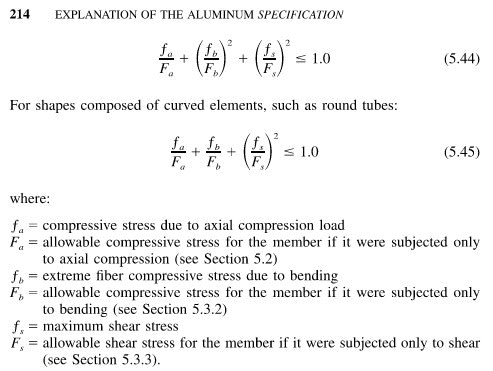

The Aluminum design code has more combinations then the hot rolled steel so you can see attached textbook "Aluminum Structures_ A Guide to Their Specifications and Design-Wiley-J. Randolph K, Robert L. F(2002)" on page 213, 214. The trosion can be resolved into additional shear and longitudinal stresses and you could use the equation directly.
But I think you are better off doing as rb1957 suggested using von Mises stress combination. See attached extract from the textbook above which gives more guidance on how to check Von Misses Stress pg 214.
