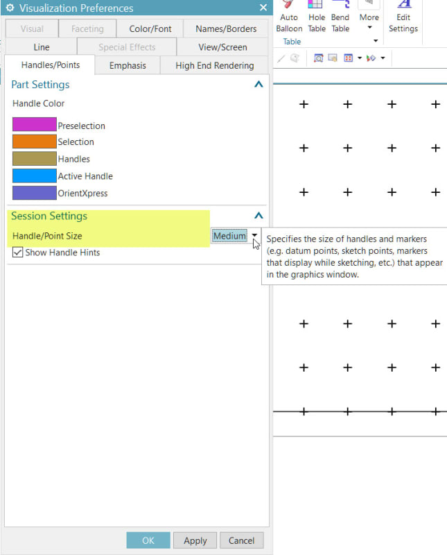

Dec 17, 2018 #1 jerry1423 Mechanical Joined Aug 19, 2005 Messages 3,428 Location US I need to show some points in a drawing view that originate from my model file. When I print the drawing the points appear too big. Is there a way that I can reduce the size of these points in a drawing view ? Jerry J. UGV5-NX11

Dec 18, 2018 1 #2 Arkance/PhoeNX Mechanical Joined Mar 2, 2010 Messages 870 Location AU Visualisation Preferences - Handles/Points (see image). Anthony Galante Senior Support Engineer NX3 to NX11 with almost every MR (24versions) Upvote 0 Downvote

Dec 19, 2018 Thread starter #3 jerry1423 Mechanical Joined Aug 19, 2005 Messages 3,428 Location US Thank you so much ! I did a search and could not find that Jerry J. UGV5-NX11 Upvote 0 Downvote
