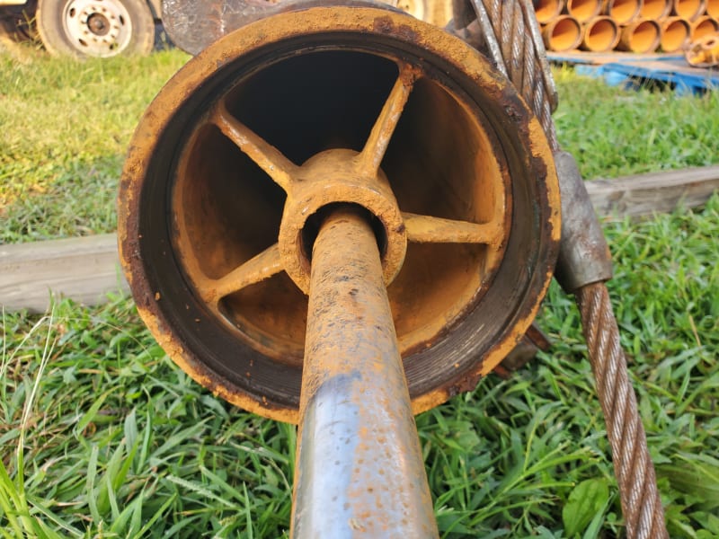

Hi. We are having issues with low reliability on a vertical turbine pump used for irrigating nursery stock. We had a failure the other day requiring is removal. It moves 700gpm at 640TDH with 290ft of column and an open lineshaft.
Upon removal it was found that the bearings in the pump had failed and wiped out two bearings above it in the column. This well has previously had issues with lineshaft breakage due to failure of cutlass rubber bearing failures due to lack of sufficient prelube. After that failure vesconite lineshaft bearings were installed to provide greater dry running durability. The pump failed after that in a similar way to this time taking out the pump bearings and bearings above it. The discharge head was leveled and the number of bearings doubled by going from 10ft column sections to 5ft to increase rigidity.
At this point we believe our root problem is the amount of sand and iron being pumped is causing premature failure of the bearings in the pump. Is there a way to improve pump reliability in these conditions short of having a new well drilled? We have gone from needing an annual overhaul to making it slightly over two years.

Cutless rubber bearings should haver been sufficient, sounds more like lack of pre-lube was the problem for the line shaft bearings. What material are the turbine bearings?
Are the replacement line shaft bearings fluted or solid? - if solid the sand could now be the problem.
Pump bearings have been bronze each time. The vesconite bearings on the spiders have straight flutes vertically down not spiraled like cutless rubber.

Artisi is right. Cutless rubber is the best material option for well water with sand. You probably need to get a well company in to bail the sand out of the well. You should run pre-lube water down the column to lubricate the bushings prior to start-up if the pump has been down for more than 24 hours.
Johnny Pellin
As has been said the Cutless rubber bearings are best for sand. You will need rubber bearings in the pump as well instead of brass. Pre-lube is important. I prefer a foot valve on the turbine pump, as that keeps the bearings submerged and lets the pump start with some load. Always best to solve the original problem if possible first, which would be the sand. Bailing might help, but there are other ways to develop a well like blowing with air that might be better. A high speed bailer is best if you have steel casing. High speed bailing causes enough suction to collapse PVC casing, which is why it works so well to get the sand out. Over pumping the well can also make sand.
Pre lube is being used from 500gal tank prior to starting. Bearing failures are occurring below static level.

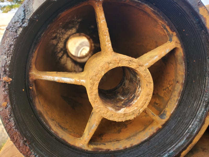

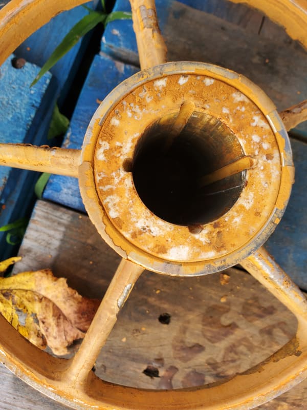

Top two picture shows an intact bearing. Bottom two are just above the turbine and have been worn completely away.
If only bearings below the static level are failing, then your pre-lube is fine and most likely failure is due to sand. Brass bearings will not hold up in sand. Use rubber bearings all the way through. I have used a high speed bailer on wells like this, and a 200' deep well can make 65 yards of sand which is replaced with 65 yards of gravel pack. Spent more developing the well than drilling it, but have perfectly clean water and no pump failures in 30 years.
