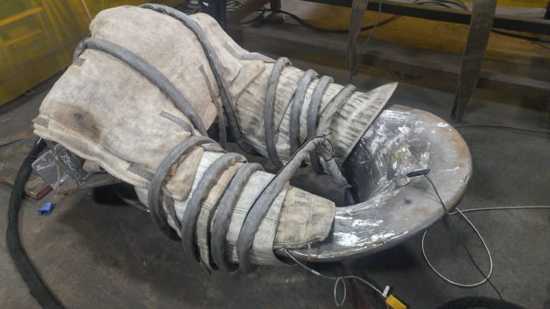

Portable Induction Coil fixturing
DAVIDSTECKER
Mar 23, 2005
526
We have a Miller Pro heat 35 with the liquid cooling for PWHT and so far we love it.
Most of the time we can warp the induction cable around the part even if it's not a true pipe or can wrap it in a flat coil as long as it is on a horizontal surface or we can drape it over the part.
We are getting into projects where we may need to a place flat coil on a vertical surface or ID of a large horizontal tube at the 9; 12; and 3 O'clock positions for spot pre and post weld heating.
I have been searching the internet for photos and videos of induction heaters in use but it seems that 99.9% of them are of welding pipe; a few fixtured flat panels but nothing really out of position; 2D or 3D.
I recently confirmed that aluminum and stainless steel are not effected by the induction field so that has opened quite a few possibilities.
Does anyone know where I can find more examples of fixturing coils or users groups or can share their own experiences?
My current work is gong to involve PWHT to 1,100 deg F although I believe our unit is capable of 1,450.
Thank you in advance.
Best regards, David

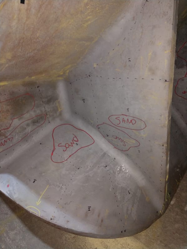

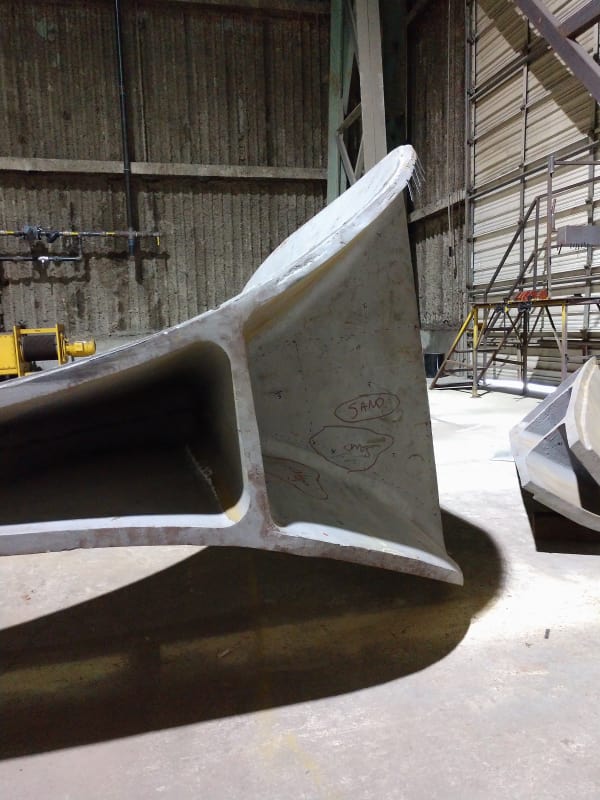

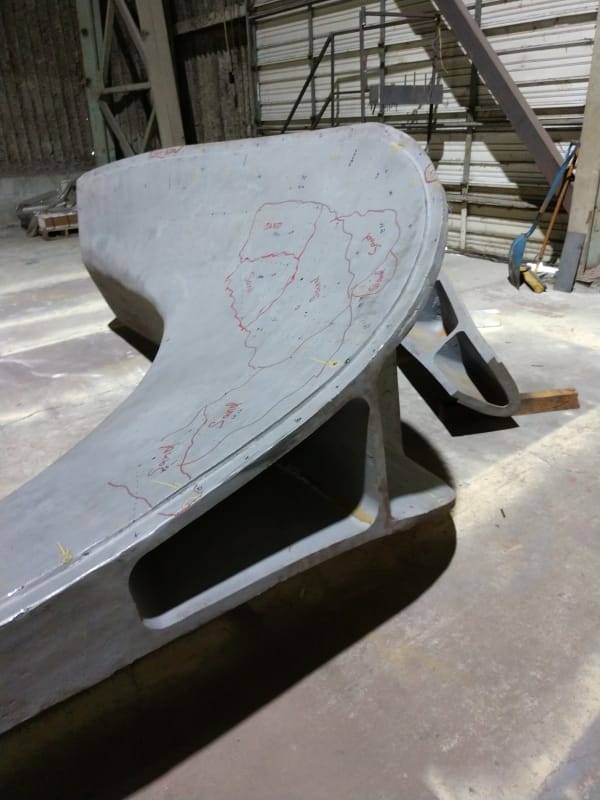

Here is an update to my current project.
The casting is ASTM A216 Gr WCA.
Here in St. Louis the shop isn't getting much above 40 deg F so I want to preheat and maintain the casting at something around 100-200 deg unless someone knows of a better choice while we air arc to remove the offending indications found by RT.
PWHT will also be required mainly due to the amount of surface area involved.
Would it required or advisable to PWHT after air arc and can I process one are at a time then move to the next?
I have a couple of Weld Engineers here that I can work with but I'll take all the advise I can get.
Best regards, David
I have nothing to offer about preheat for air arc .
You probably already have also read this in A216 -
10. Repair by Welding
10.3 Castings containing any repair weld that exceeds 20 %
of the wall thickness or 1 in. [25 mm], whichever is smaller, or
that exceeds approximately 10 in.2[65 cm2] in area, or that was
made to correct hydrostatic test defects, shall be stress relieved
or heat treated after welding.
I am dubious about how induction heating could work on such a large, non-cylindrical part. This looks like a job for natural gas fired radiant heaters; the second choice would be electric resistance heating pads (slower and more costly).
For purposes of preheat I treat thermal gouging operations the same way as welding operations; in other words, I generally require the same preheat for the material and thickness as I would for welding.
If you have a couple of Weld Engineers, why can they not help you?

We have used the induction system in slightly different ways such as pre-heating this casting for hard surfacing.
While we were able to wrap the cable around the part we could have done it with two flat coils draped over the curved surfaces.

I have used induction or electric resistance heater pads for CA6NM grade castings. But for 216 grades,, I just followed the ASTM recommendation even for large odd shaped castings.

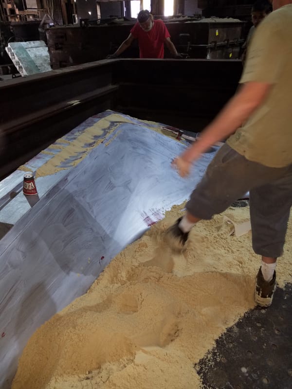

The castings looks nice ,what was the sand system used?

The foundries web site states that they use a sodium silicate no-bake sand system.
I'll pass along you comments although they've sent me some that look like death warmed over.
Sand inclusions do seem to be one of the most common defects we have to deal with.
To their credit, we do make a lot of large items with some expansive thin sections so that leads to some higher flow rates of the metal and erosion.

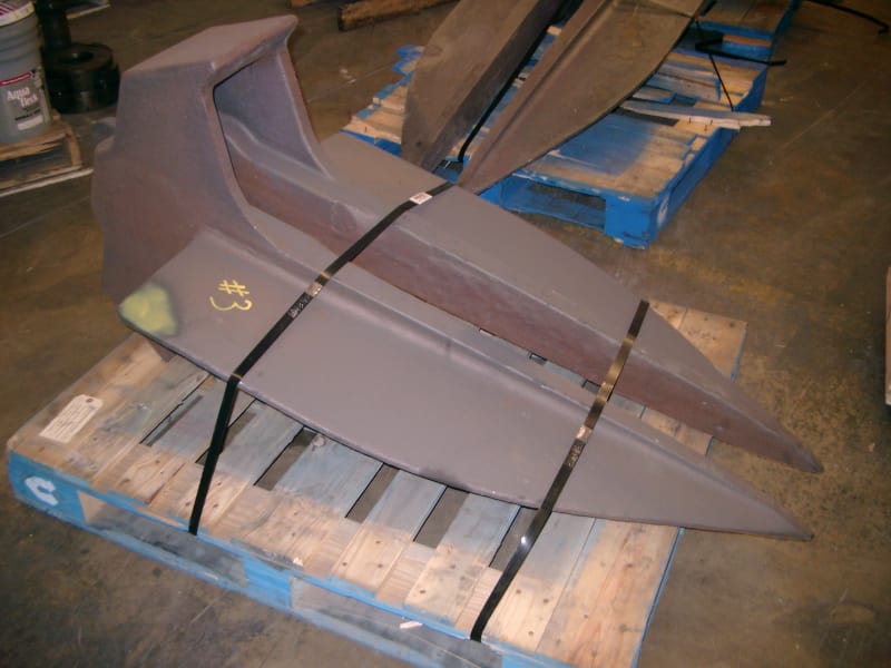

This anchor crown and flutes is a good example.
If they can change to Furan resin sand,, sand inclusions would be reduced drastically.This looks like a ship anchor casting. what class? Its is not a simple job that every foundry can attempt.

The last photo is for a Navy Light Weight type anchor, full MIL spec.
Some times we make this style out of Hadfield Manganese so they are non-magnetic.
Big pain in the A**.

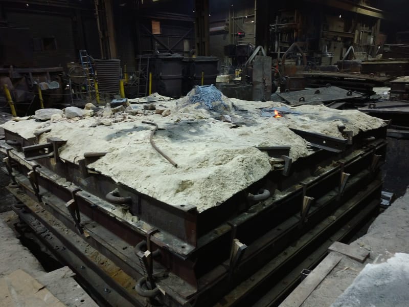

I think the assembled mold for the part I'm working with came in at around 35K.
With this being a one off there is a lot of manual labor and a lot of territory to cover so trying to beat the clock could be a problem.
If you are thinking of holding your coils in place with SS braces please check and make sure that they are really nonmagnetic.
They will still heat because they are conductive, but a lot less.
David a candidate casting for 3D sand printing. You could get them printed in less than a week and have them cast. Well,the mould and core material is Furan. I make these castings and I know the exact spot where it pains.

I'm probably going to go with 6061 aluminum since we also fabricate with a lot of it here, I was thinking about 316 SSTL wire but might switch to aluminum as well even though we do have a gage for magnetic permeability.
I ran across a sheet product called Isoplan that I am thinking about as a backing material to hold the coil shape in position.
I've seen wood and plywood in some fixtures but I think they were mainly preheat and not PWHT.
I have lots of nooks and crannies in less than ideal positions to deal with.

Have you done much with WCA with regards to repairs that require PWHT?
I've been communicating with the foundry and I am getting the impression that I don't need to PWHT until all of the repairs are complete, and not while the area is still at weld temp.
What are your thoughts?

Be careful with using Al, it starts getting very soft at fairly low temperatures.
SS wire is a good option.
Esdtainless,
The temperature outside of the 1" thick thermal blankets where the coil and fixturing shouldn't get that hot.
While it does get pretty warm outside with the inside at 1,100 deg I don't think that it gets too much over 200 deg if I recall.
Having formerly worked at a foundry, we repaired millions of pounds worth of WCA/WCB castings and allowed the welds to cool to room temperature before PWHT. And as your foundry implied, only PWHT-ing once all the repairs are done is adequate. Never had a problem doing it that way that I recall.

An impressive lack of PPE on display by the personnel ...
