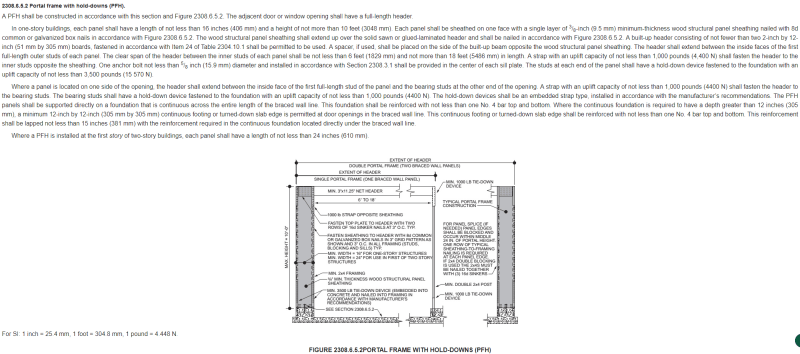

Hi all,
I've got a question about the Portal frame with hold-downs (PFH) detail in the 2015 IRC (R602.10.6.2) and 2018 IBC (2308.6.5.2). I have seen many versions of this detail drawn and many of them mention a double, or even triple sill plate being required. In the language of the IRC and IBC I cannot find anything talking about this sill plate requirement, yet many of the details I see out there specifically mention that the codes require the double or triple sill (see image below for an example). Do any of you know where this requirement is mentioned?

What do “2015 IRC (R602.10.6.2) and 2018 IBC (2308.6.5.2).” actually say and pertain to? Somebody post them for our/my reading. What did they read into those code sections? I no longer go broke buying code eds. which I seldom use. Much of that stuff (tabulations, frame cap’ys., etc.), are in good part, based on their testing and approach to the analysis of the particular problem (not some code para.), so call Simpson’s engineering dept. and ask them where it came from, or where their citations say that. If they intend these to be used under the IRC, without any engineering guidance or actual design, they will intentionally be conservative where there is any doubt.

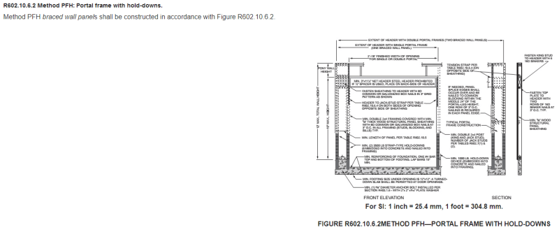

Hopefully you can read these or at least zoom in.
The only thing I see indicating this is the image itself. The 2012 IRC does in deed show a triple plate where as it is shown as a double plate in the newer versions. It is not specifically called out in any of them that I can find.
JungleJoe: Thanks for the info. and your efforts, but when I enlarge the figures, the print gets too fuzzy to read very well. Copy quality is lost in file transfer or something, if you can read your copy.
ChorasDen: Thanks for the links, those I can actually enlarge a bit, and read. The IBC section presentation looks much like what you might expect to see in the IRC, maybe almost lifted from it, very prescriptive in nature, maybe from some of Simpson’s early work and testing.
I don’t see anything in those exact code sections that really gives me the answer or direction for explaining the conundrum. I’d want to talk with some Simpson engineers and the code people who might remember how that all developed. These days, codes are changing so fast and the want to bring new products to market are happening so fast, and no real history record of the development is being kept, to help guide us with these types of questions or discrepancies. I’m sorry I can’t be more helpful.
