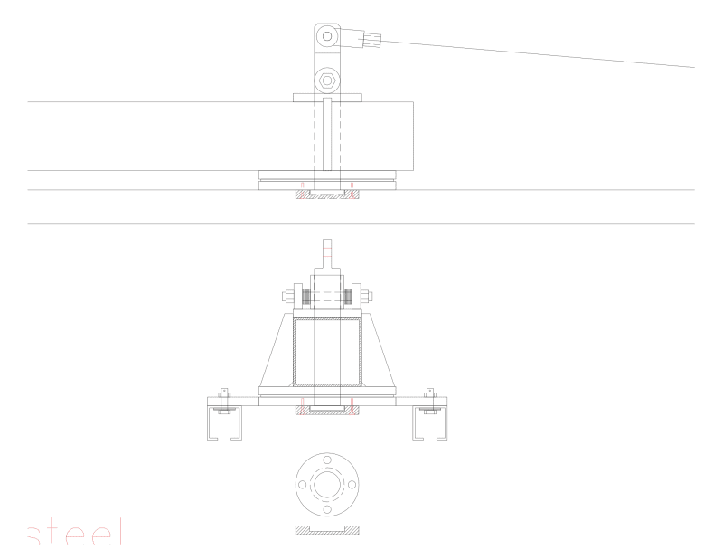

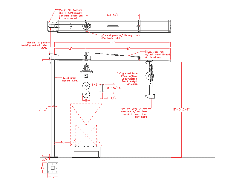

Hi Everyone,
I'm designing and making this post and arm for a manufacturing client.
They need the track overhead to hang the air tools from balancers, but they also need to rotate the arm to gain clearance to drop over the cover of the unit for shipping then rotate the arm back inline and staple it shut. This process is repeated at least 10-15 times a day.
The weight I'snt very much unless a worker pulls down with his own weight on the arm, which I have to account for.
My questions is:
Will the tubing I'm using (4x4x1/8 wall steel square tube) hold up with the torsional forces and tension forces ?
I really wanted to use a 6x6x1/4 wall aluminum tube but I fear overtime it will suffer from microscopic stress due to cyclic use compared to the great endurance steel has with repeated use. Or would 3x3x1/4 wall steel be better than the 4x4 1/8th steel
Anything else you notice might be an issue or if you can recommend thing that would be great.
My drawings are attached.
Thanks !
Joel
What are the stresses due to torsion and tension calculated in your analysis?
Also curious what kind of deflection the tube experiences as it is a long cantilever for a 4" tube. What does your analysis suggest?
Why is the drawing so faint? I am having trouble reading it.
I'm still in design stage, have yet to submit to my engineer.
I made a mock up in my shop to see where it deflects and how much. Bit of tension/compression in the arm tube 12" off the post vertically and it does experience torsion when the tracks are rotated perpendicular.
The original request was for a post and jib swing arm.
I attached a PDF as well you can zoom in on that and see details, the picture ones aren't as nice as they're converted from pdf online.
My question this time is :
I figured extending the arm out a bit from the post and then the tracks hanging off that point would help spread or Share the stress, as compared to a jib swing arm which puts all the force directly on the post. I'm trying for a lighter easier structure as opposed to a big giant heavy thing that spans 10ft directly off the post. Maybe I'm completely backwards in my thinking?
Thanks ,
Joel
Which steel square tube would perform better in this case?
3x3x1/4 wall or
4x4x1/8 wall
Is a larger thinner perimeter stronger than a smaller heavier one ? Or same ?
I'm thinking the 1/4 wall because really I need more material in my tension flanges of the tubing, I could maybe weld a flat bar to the top of the arm tube to keep it from deflecting.

Is a larger thinner perimeter stronger than a smaller heavier one ? Or same ? You're a structural engineer and you're asking that? Give us a break!
Why ask us? We don't know the loads. Why limit the choice to those sizes? What is wrong with:
4x4x3/16, 4x4x1/4, 5x4x3/16, 6x4x3/16 or even 6x6x3/16 wall if needed? You were prepared to go to 6x6x1/4 aluminum HSS.

No matter what, the load is being carried by the post. Adding a joint in it doesn't make the load disappear, it makes the load path more complicated.
Some of the answers are an hour or so of work and you said you have your own engineer.

I'm meeting with the client tomorrow I'll see if maybe I can center the track under the arm instead of such a big offset on one side. That will help reduce the torsional forces on that arm. Like you say no matter what still tension/compression on the post but just a tiny bit since it's not actually a crane.

Good news the client today actually doesn't need the offset arm or the fixed arm extension off the post either.
Were going with a 6" Diameter x 1/4 wall round post with two smaller jib style arms that rotate right off the same post independently (8Ft max span off the post.) Slider tracks will hang below the arms.
Once I'm finished I'll post the final design.
