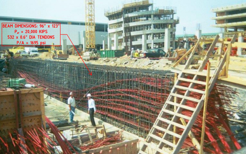

Hi everyone,
I need to design a 60ft span transfer girder supporting a column that sees loads from nine stories above. My girder c/s is 66in wide x 76in deep. My tensile stresses are going beyond 12sqrt(f'c) i.e. in the cracked zone. Also my P/A is around 750psi.
I am using a cracked section. Is this something i should be concerned about?
Also, What is the permissible (industry standard) precompression stress which I should absolutely not exceed?
I am doing this for the first time so even if there are any obvious inputs/comments that shall be really helpful.
As long as shortening is not heavily restrained from shortening, I would not be worried about that level of P/A or the fact that it is cracked.
As long as you fully account for
- crack control checks
- deflection check considering cracking, tension stiffening, creep and shrinkage (not by factor method). Deflection limit should be far tighter than the normal beam deflection allowance as the beam is a "settling support" for the structure above.
- compression stress at service
- stage stressing effects
Similar to rapt, assuming no significant restraint-to-shortening, I would not be too concerned about these P/A levels.
Given you are in California, I am assuming this will be a UNbonded transfer beam - if so, you need to consider your non-prestressed mild steel reinforcement based upon satisfying: a) your flexural tensile service stresses (crack control), b) your flexural ultimate strength requirements, and also c) robustness/resilience of the beam element with unbonded PT.
Purely for illustrative purposes - not endorsing this design (it is not mine) - here is a photo of one of two transfer girders to FIS Parking Garage at Houston, Tx. [Note the level of P/A]:
