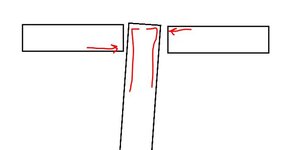

You can consider your tendons at the top to contribute to your negative moment flexure capacity.
I somewhat disagree with that and feel that, fundamentally, this is probably the best reason not to use the PT for the moment frame.
@KootK
I was primarily considering an interior condition when I made my statement, and should have clarified. In an end span condition, I would assume that the tendons would be lowered from the top of the beam to the center of gravity of the T-Beam section - reducing their efficacy in providing top flexural capacity..
I would think that in your graphic, the flexural capacity is not "turning a corner" but is provided by the column reinforcement being hooked/developed at the beam/column joint. If you replace the tendons with rebar - you still have the same need for column flexural reinforcement development into that joint. In your graphic, I have not questioned the development of tendons in the same manner that one would hooked flexural reinforcement. Probably remains as a point against utilizing PT for lateral moment frame behavior.
I was too. I just showed the end condition because it elucidates the concept more convincingly.
I'm afraid that's fundamentally incorrect EZ. The moment capacity absolutely does need to turn the corner, as the moment demand does. It's only a matter of how you accomplish that. At an exterior, roof condition, you've really got no choice but to literally run your reinforcement around the corner. At joints where the column or beams are continuous pass the joint, you've got the clamping mechanism shown which is sort of a "cheat" that allows hooking/developing to be enough. This tends to create understandable confusion amongst designers about how it all works.
