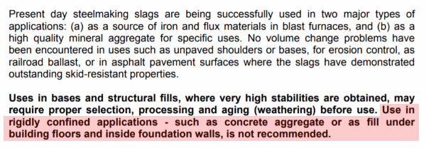

Be careful with that slag. Some slags are expansive.
I worked on a site where the original contractor "saved" money by using a cheap slag as backfill around the process pits. Later on, the floor slabs and pit walls were all heaving making the cart runs unusable. The original contractor ended up building a new facility for the owner for free and I heard paying for lost profits in the interim. Original savings were on the order of $20,000. Final liability was reportedly 10s of millions.
per Jdonville, I'd run a sample to a geotech lab for tests on potential swelling, possibly related to take=on of water, etc. The least one should do is check where the stuff has been in use for at least a few years.
regarding slag: jdonville brings up the correct point. Especially true if somebody tries to stabilize it with cement, lime or other such basic stuff. Remineralization can/likely-will occur. Hotel Roanoke (Virginia) had such troubles.
f-d
ípapß gordo ainÆt no madre flaca!
Excerpt from "Properties and Uses of Iron and Steel Slags" published by the National Slag Association.
[idea]
Thanks, guys. Very timely information. I'll look into other end uses and see how the performance rates. I know it has been used under slabs in the facility before - I'll see if I can get my hands on any testing that may have been done then.
That was my thought exactly. I just checked, and indeed there have been some swelling issues for lightly loaded areas where it was used. When used in heavily loaded areas, there's no measurable swelling effect. So it seems that if the load is high enough to cause significant settlement, it's heavy enough to force the swelling into the native soils. If it isn't, then it's not heavy enough to do so and the swelling is pushing it up.
