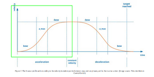

A lot depends on how you want this mass to accelerate? a smooth RPM flat line over time ( constant acceleration until you get to 3300) or more of a parabolic curve with greater acceleration at the beginning and less at the end. If the power was constant then the torque needs to vary over the acceleration time and would probably give you you lower power, but higher torque at the beginning and less at the end.

I am looking at a linear acceleration which the VFD will be programmed to do.

I am looking at 3300/600 = 5.5 rpm per sec. That's linear acceleration, right?
