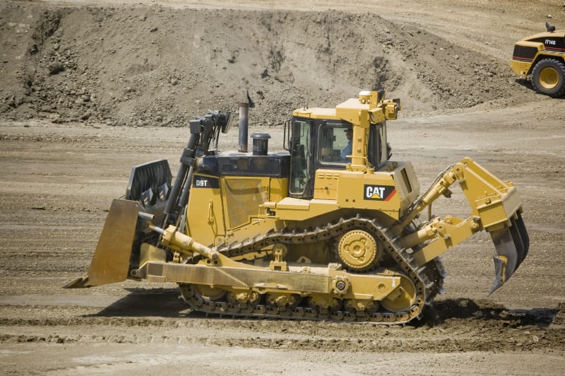

As a matter of practical interest, could you please explain exactly how you do that? D9 method, or do you have some other techniques?
For smaller lines and shorter cold spring lengths, a choker and come-along or two might get the job done. Otherwise I think the D9 sideboom method is standard.
So you are talking bending prestress. I was wondering about axial stress. That can get to be a bigger job than what several D9s can do for any decent size pipe and, if cold, you have to compress it, then there's buckling worries too.
Thanks everyone for the input! It sounds like it is largely a means and methods issue with no particular industry standard solution.
Also now I know about the D9 technique! [tongue]
