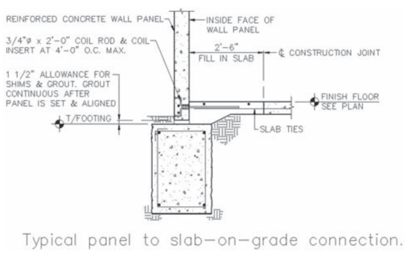

Brad in looking at the precast shop drawings I do not believe there is a connection between the slab and the wall. We could recommend connections if required.

What is your role on the project? In our area there is a EOR. That person defines how the precast is to be arranged. There are many options how the forces are resolved. If left to the precaster, they tend to pick what is advantageous to them and do not consider other factors.
Brad, we are the EOR. Precast wall is connected to foundations via Angles and embedded studs.
Ok. I see details like the one pictured below frequently. Some use threaded rods, others use weld plates that are patched after welding. I do not like that detail mixed with other footing connections if your footing is shallow, but many EOR's have insisted we use both over the years. You could look at something like that before adding odd details to your footing to deal with sliding forces. I have neve encountered a case where sliding was a problem, but we do not work in very high seismic regions.
