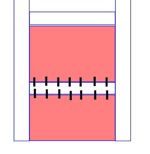

One of the cases of concern that I mentioned is that of only anchors at the ends of the panels as shown in the first sketch below. Hopefully the sketch makes the concern self evident. It's a bit more common of a case than one might think because many shear friction recommendations are predicated on flexure shifting the location of shear transfer to the compression zone.

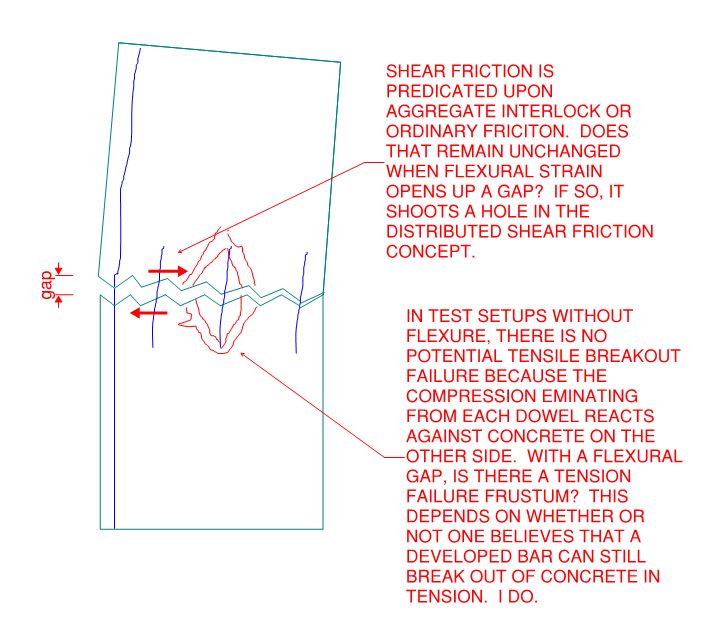

The other point of concern that I mentioned is shown in the second sketch below and it results from the test setups used to evaluate shear friction capability not having meaningful flexure present.

I'm familiar with that popular distinction but consider it something of an oversimplification. At the end of day, stresses are stresses, failure mechanisms are failure mechanism, and a thing feels what it feels under load. Having put a particular situation into a convenient taxonomic bucket changes none of that of course. In my opinion, many cold joints will start to slip into something of a grey zone between rebar theory and anchor theory.
Nobody should believe in magic. There are always nuances and costs to things.
The easy rebuttal to my hypotheses here is "properly designed flexural elements don't open up enough to create those issues". But, then, can that be proven to be true?

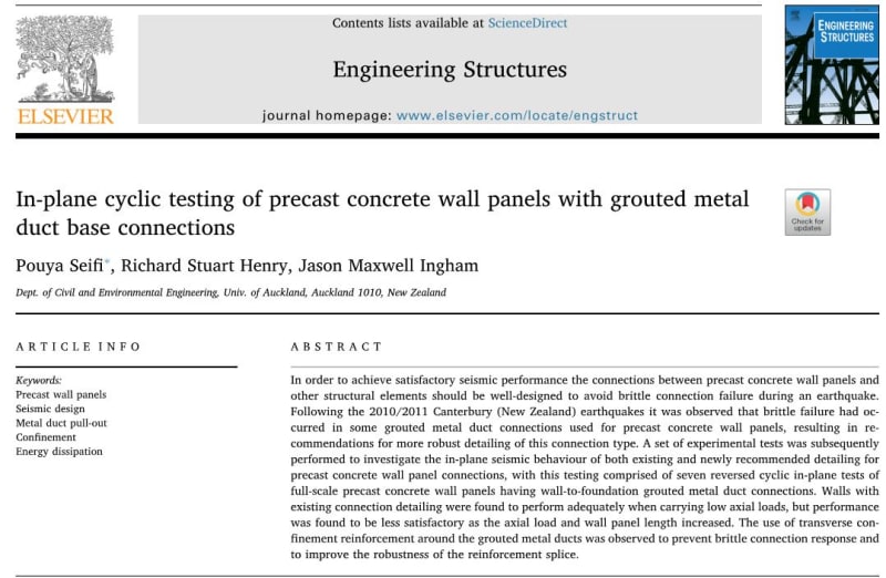

Kootk, this thread shows the ideal/recommended arrangement in NZ following our experiences learnt in our 2011 earthquakes.
The issue we had was while the strength of isolated bars was fine on paper for equilibrium, we had bars at ends of walls fracturing under cyclic loads due to the very low reinforcement ratio. Strain too high basically and suffer low cycle fatigue failure concentrating all the inelastic strain in a very short portion of the bar.
Put more bars in wall ends (like equivalent reinforcement to the wall vertical steel) and you reduce this possibility. ACI code directly adopted the exact same learnings by increasing minimum reinforcement content in wall ends that we introduced. Doubling the previous requirement from memory.
Any connections between wall panels should follow the same principles regarding reinforcement ratio. It's possibly the worst thing to do just satisfying equilibrium with a few isolated bars at wall ends as per your example.

Agent, I was reading the study below recently, and see this is a common detail. Can I ask if it is common to connect panels in a similar manner at the vertical joint lines or do most EOR's design the foundations for the forces without panel to panel connections? Any chance you can point to a NZ study showing a nice method to determine the panel/panel forces? We use FEA methods, but I have never been completely satisfied with that.
Brad, really depends on building and whether you need the longer wall as to whether they are jointed.
This document is a bit old but it gives a flavour for how walls might be joint in NZ. Refer to section 4. Some of the more elaborate ones I've never seen in practice, but the half thickness joints or full thickness seem to be the most common.
In terms of evaluating the forces crossing the vertical joint, isn't it just a matter of evaluating the wall bar and compression forces and evaluating the longitudinal shear (when the wall is at its ultimate strength/capacity). In squat walls strut and tie could help. Even a section cut on etabs is probably sufficient if your wall is elastic.
