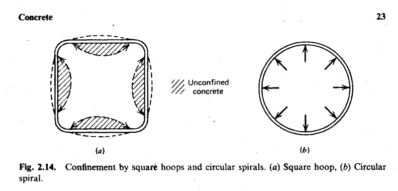

If so, why do we need to confine the internal bars in columns considering we have outmost closed ligature already?
By confining outermost layers, I mean links or stirrups between the 2 outermost layers in a wall.
In a column a single stirrup around the perimeter does not confine concrete at intermediate bars locations. Put another link at the midpoint in the following picture and the zone of unconfined concrete reduces. For a wall you need regularly spaced cross ties along the length to achieve the same effect.
