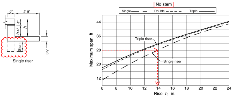

probably worth it to run though a calc, assume some initial prestress, and see what the long term deflection comes out to. PCI has coefficients and such to figure long term deflection. If you cant get close to the field measured value, then you can worry.
loss of pretension or creep and most likely both. Are the sections a double L-type like in the picture above or a sigle L-shape?
Ran some rough numbers with a lot of guesses. Assumed f'c = 5000 psi, (2) 1/2" dia. 270 ksi low-lax 7-wire strand stressed to a target of 31 kips per strand, assumed 60% relative humidity. Probably not conservative enough but it's just a quick check.
Looks like they prestressed very close to the centroid; so vertical camber will be minimal. The non-prestressed principle axis are only 7 degrees off of the horizontal so I'm mostly neglecting that effect for expediency, the adjacent risers and attachments will probably restrain the section to some degree. I roughed in the non-rectangular section pretty quickly and may have goofed on that in my calcs.
Unless there's something I'm missing the section is compression controlled. That tiny 6" wide block at the top doesn't give much area for compression in the section so the c/de value I calculated was much greater than 0.375. Again, rough calcs but I wouldn't be surprised if it was indeed compression controlled. I also don't think there's enough strength here if it is compression controlled. This would explain the lack of cracking if it was losing prestressing and would be very dangerous.
As for deflection, I came up with the following using PCI prestressing loss estimates:
Initial camber at release = 0.298 in
Deflection at erection = 0.340 in
Long-term dead load deflection = 0.422 in
Total D+L load deflection = 0.687 in
I didn't calculate the deflection using an effective moment of inertia as I should. But, if I'm anywhere close, there's something strange going on here if you're getting that large of a deflection.
Definitely worth more than my quick look. I fully admit I may have goofed in the math as I threw this together quickly. Still, hopefully this helps.
American Concrete Industries
Assuming vertical-axis bending only, CG is 4" from bottom of section. Prestress looks to be in center of bottom flange, so 3" from bottom, so eccentricity of prestress, e = 1".
Assuming Pef = 54 kips (say 2 x 1/2" strands), I calc an uplift due to prestress ONLY of 0.11" (upwards: ie P*e*L2/8EI). Compare that to a SW deflection of 0.45" (downwards: ie 5*w*L4/384EI), and the net result, based upon GROSS section properties is 0.34" (downwards). So there is NO camber.
P/A is 250 psi, based upon gross section - so it has some precompression. Bottom tension fibre is about 240 psi (tension), so theoretically NOT cracked under SW.
BUT, the significant SW of the section adds another 1000 psi of compression to the top fibre, and with such a small compression area, creep is significant.
So creep after 30 years, applied to a downward deflecting section, would be say 4 to 5 x elastic deflection and 0.34" becomes 1.5" over time.
Pepperoni: Do you know if the concrete is light-weight?
Also, PCI 7th edition design aid table 3.12.11 on stadium risers, may be of some use:
...and note the bottom flange thickness of only 3.5" compared to your 6"...you have a lot more SW!
