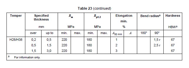

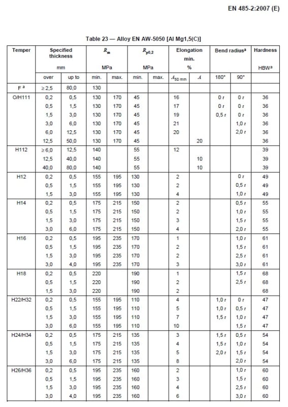

From the spec, "for information only", whatever that means.
Hi everyone. Thank you for your replies. Yes I know about the tables and rules of thumb. I did not know about grain direction, so thank you for that. I was hoping it was possible to calculate, but it appears not.
